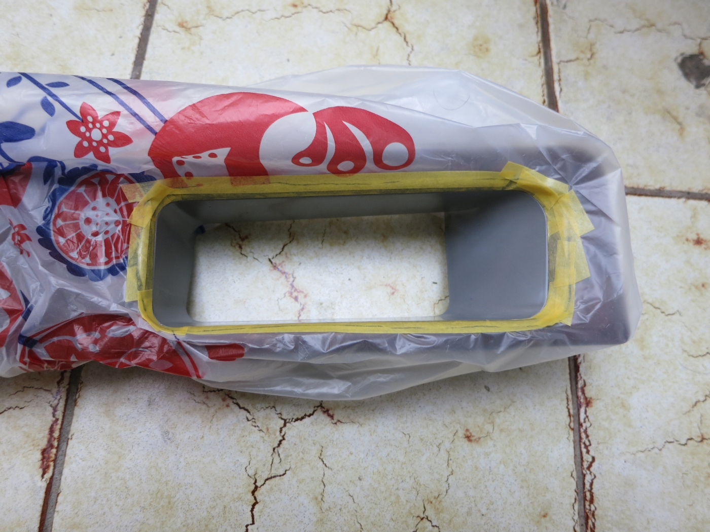

Also, for the grab handles they are easy to repaint yourself with high quality Tamiya spray paints, they are synthetic lacquers and have a excellent finish.
I used Tamiya masking tape and a shopping bag to mask the wood effect trim.
This is from the S8 I sold.
The original vinyl covering will come off with some isopropyl alcohol and kitchen paper towels. I didnt bother sanding the hard plastic underneath.
Not perfect but much better than before

Goran, congratulations on what seems like a very good paint job result. I saw the picture on how you did the masking job and like to mention how I did mine. I used PlastiDip applying 2-3 coats and peeled away the lower part after cutting with a sharp knife in the crack. After the paint job was done I just peeled off the PlastiDip stuff.
My first attempt to repair was using PlastiDip only, but as others say it doesn't take much before it starts peeling if you're not careful. The result may be better if you make a mix of thinner and PlastiDip 1:1, certainly closer to the original touch and feel.
