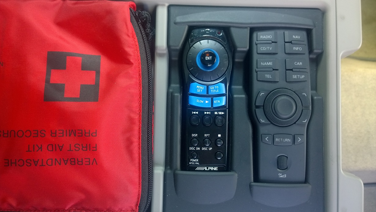

I have one of these. It also comes with a separate remote for the rear seat entertainment. All fits in the rear center arm rest. I can show you a pic when i get home from work.

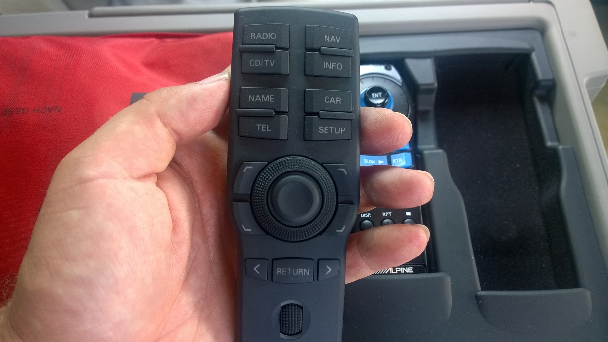

Couple of people have asked me if they can see a pic of my MMI remote so here it is. It fits in the armrest next to the Alpine rear seat entertainment remote as you can see in the pic. Also i think it works via bluetooth as you do not need to point it anywhere for it to work. If anybody wants to have a look at it then i will be at AITP
