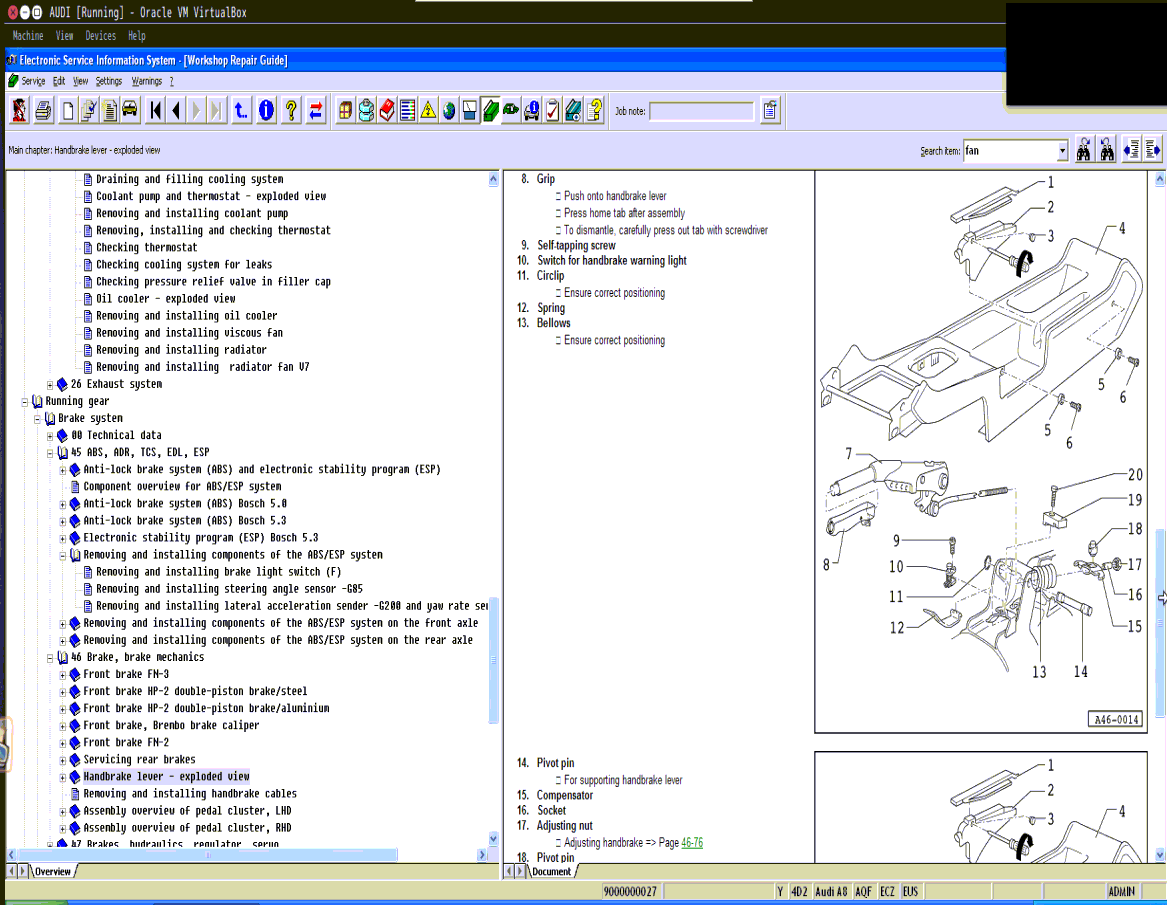

I've just had a look on ElsaWin and it looks quite a detailed job to someone of my limited ability ;-)
Item 10 is listed as the handbrake switch.

Thanks for that, definitely looks like it's all hidden under the centre console.
I think I'll just live with it.
