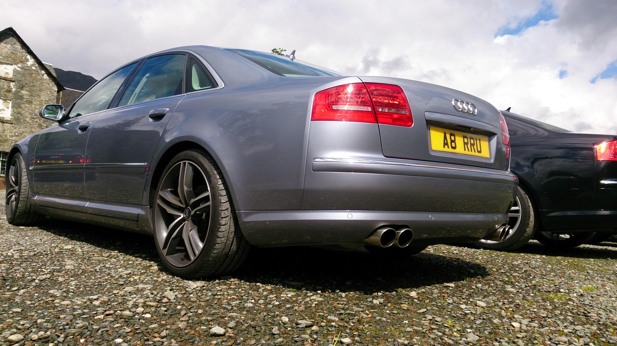

look at this picture, this is 9'' rim, 20s, ET28, smaller number further they stick, plus rear is lowered by 10mm, now the question is how much further you want to go, and they are 255 tyres so 275 will look slightly chunkier and closer to the arch due to the extra width and slightly higher sidewall
I wouldn't be surprised if the ET number, like 25 are actually the mm's from the center of the wheel to the fitting point as thats how ET is measured and means, distance off the wheel's center
front is 35 and it really needs to be changed to 28 as the rear, but front seats 15mm lower
Hope that helps, I spent lots of time on it when choosing my wheels and knowing very little about the width, et, etc
