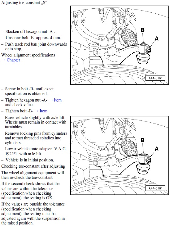

Lowering car will certainly increase tyre wear on the inside. Another thing is that could affect is that TOE constant S is not always adjusted correctly when doing wheel alignment or after changing track rod ends. They just crank up bolt 'B' all the way thinking it'e there for securing not for adjustment.
