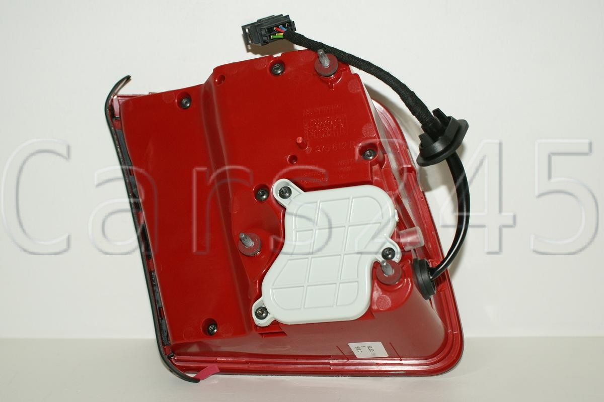

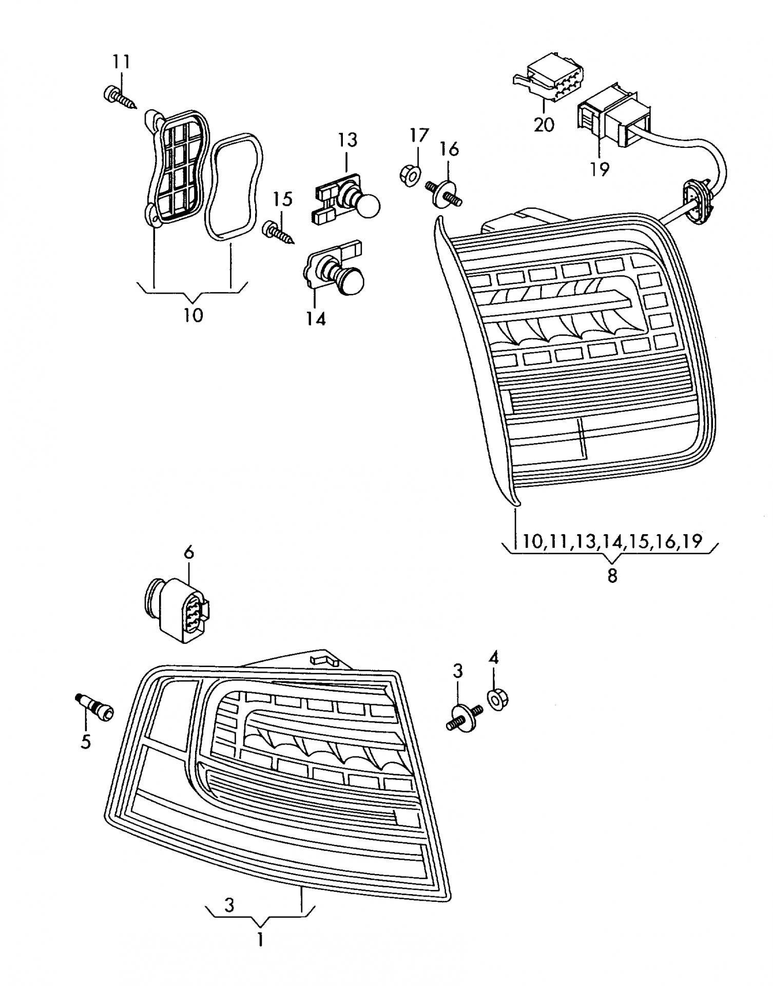

Just found a photo on eBay of the back of one of the lights and also an exploded diagram of the same cluster in the parts catalog, so the white panel comes off and there is a pair of incandescent bulbs in there and a seal to keep it dry. Time to take this apart and dry it out and make sure the seal is sealing properly. Maybe it wasn't installed correctly at the dealers.

If you can take the light off and keep them at home overnight in warm condition and put some Silica gel packs inside then I'm sure you'll be able to get rid off all the moisture from inside and then all whats left is to find where the water comes from and make a new good seal
