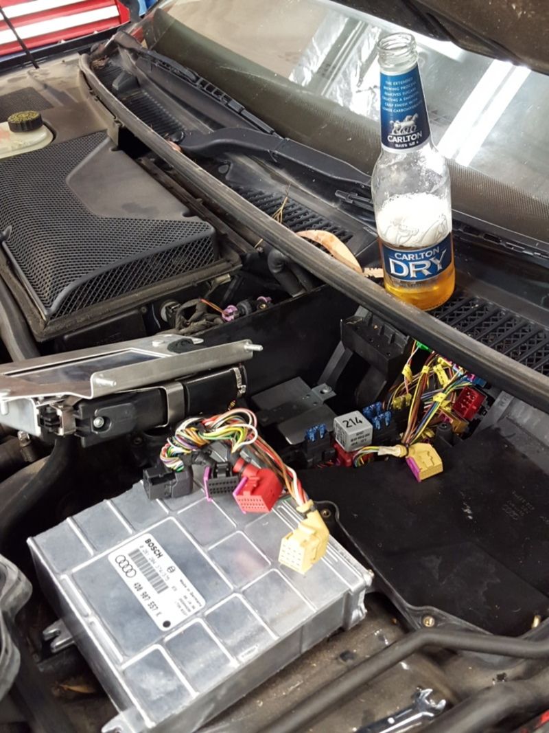

Old 5th January 2016, 06:57 AM
RacingR RacingR is offline
Join Date: Oct 2015
Posts: 51
Found it, ... pic for RHD owners reference.
Now to fix
