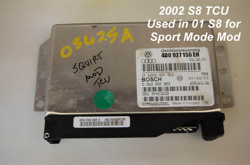

If the ECU's are essentially the same nothing stopping you desoldering the 27C1024 chip (Which I 'think' is in these ones), and backing it up, then reading from a good ECU and writing it in.
If someone has an 'old' ECU and 'new' ECU I will happily open them up and see if we can update an ECU via. a software flash only?

Pic 1 of standard older S8 TCU courtesy of A8 Parts:
Pic 2 of the newer TCU courtesy of Paul W:
They look identical in fitting way and reading up is the same pinout.
If we can get an older one and a picture inside I can examine it from there?
If it's a go-er I can tweak the software inside of the standard one and enhance it properly from there.
Very simular to the RS6 TCU as well....
