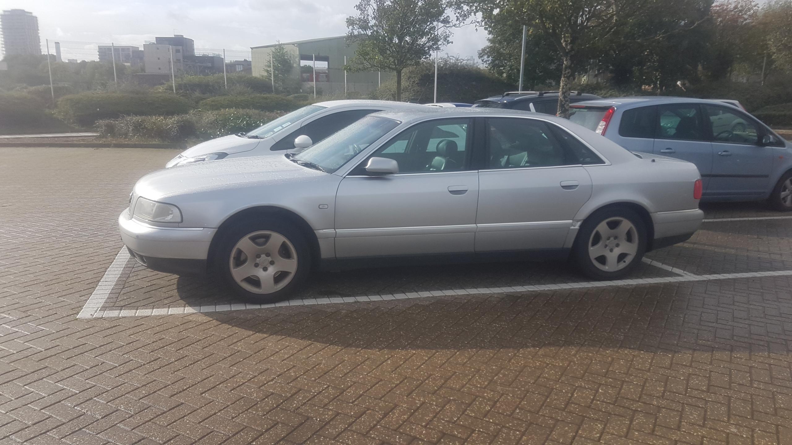

I'm not looking at lowering the car tbh, I do 30k a year up and down the M25 and A1, so I much rather have the comfort, but at the same time I want to be able to have 5 people in the car without exhaust hitting the floor.
Looked at arms and few bushes could do with replacing, shockers look to be original still but not sure if replacing shockers alone will help the ride height.
I have B6 Bilsteins with original springs on my UrS4 and they're just awesome but it is little harsh.

I'd be inclined to look at some Sachs OE replacement springs in that case. Replacing the dampers will make no difference at all to ride height.
