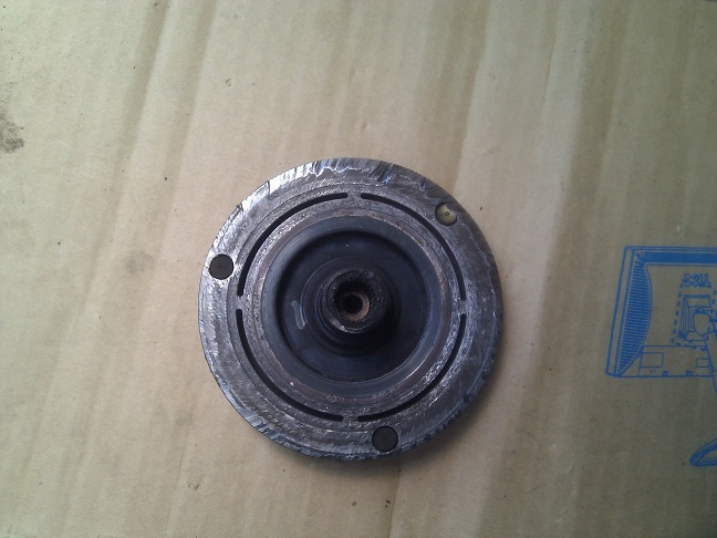

Similar problem but fortunately not lethal. Found this on engine undertray on A6

Is that a relay roller?
Old 2nd July 2011, 09:31 PM
Posts: 3,849
Half or should I say third of AC compressor pulley/clutch. Bolt have become undone and was missing. Main part of the pulley and the belt was still on. Wife complained that AC was not working couple of weeks ago, I did all the electrical tests and they were fine, thought maybe belt was gone but did not look at it as I was going to service soon car soon (today) and left it as it is until now. When removed undertray to do oil change there it was. New M6 bolt, washer, threadlock and couple of minutes later we have working AC again.
