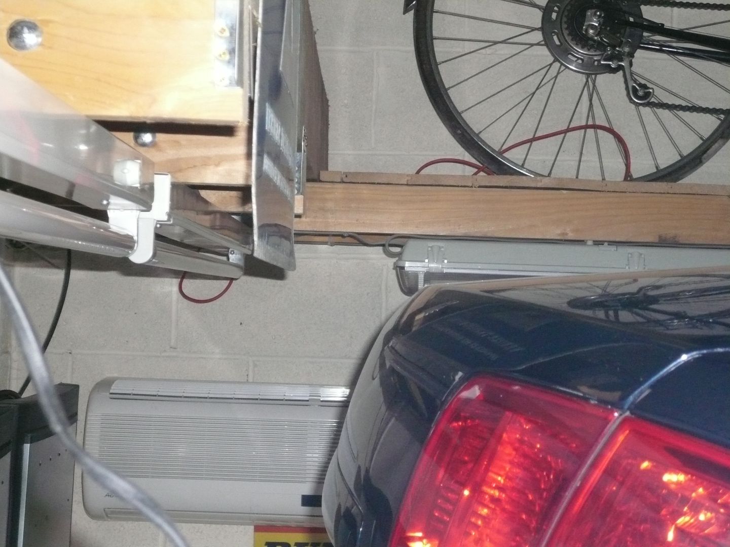

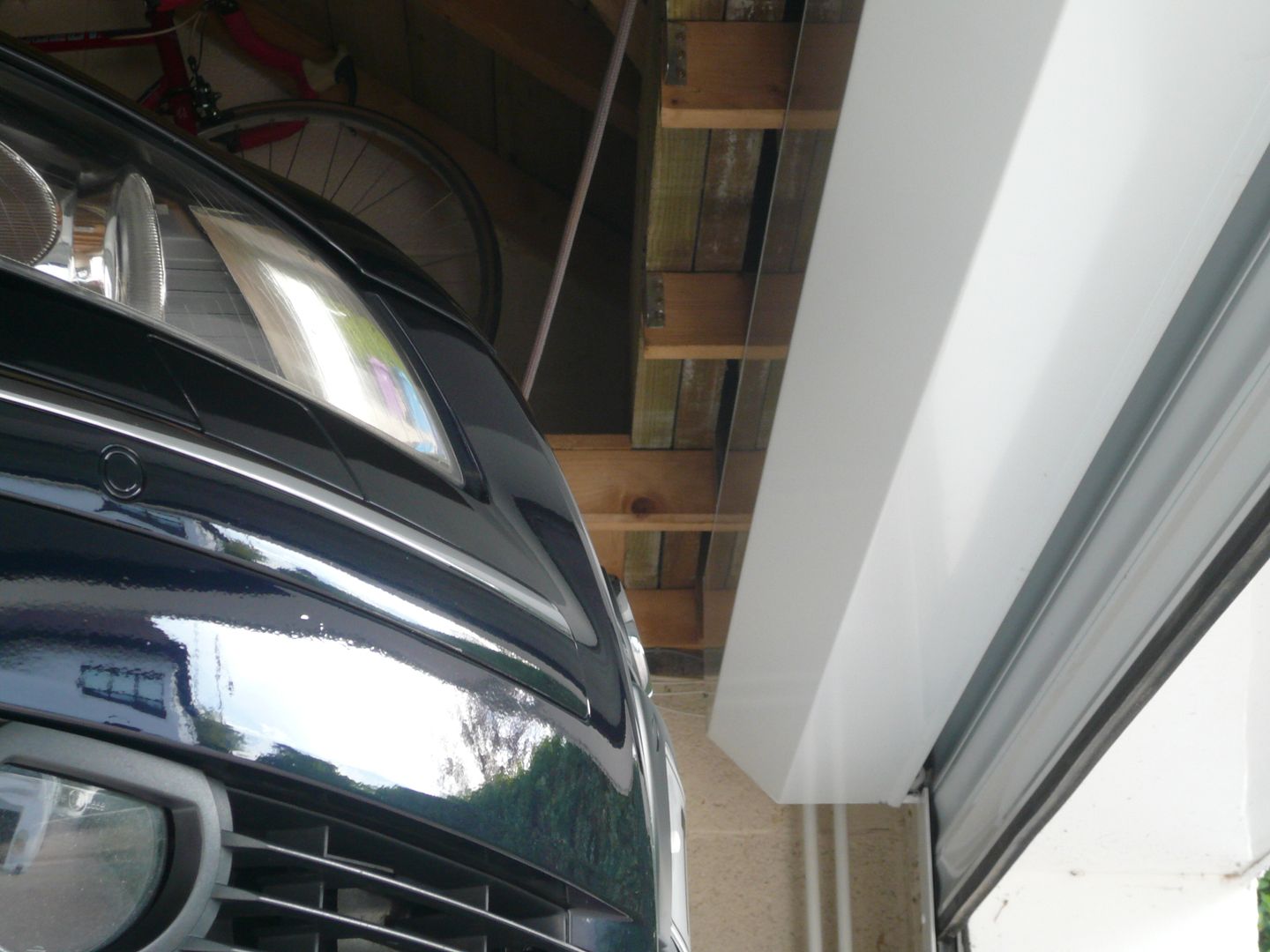

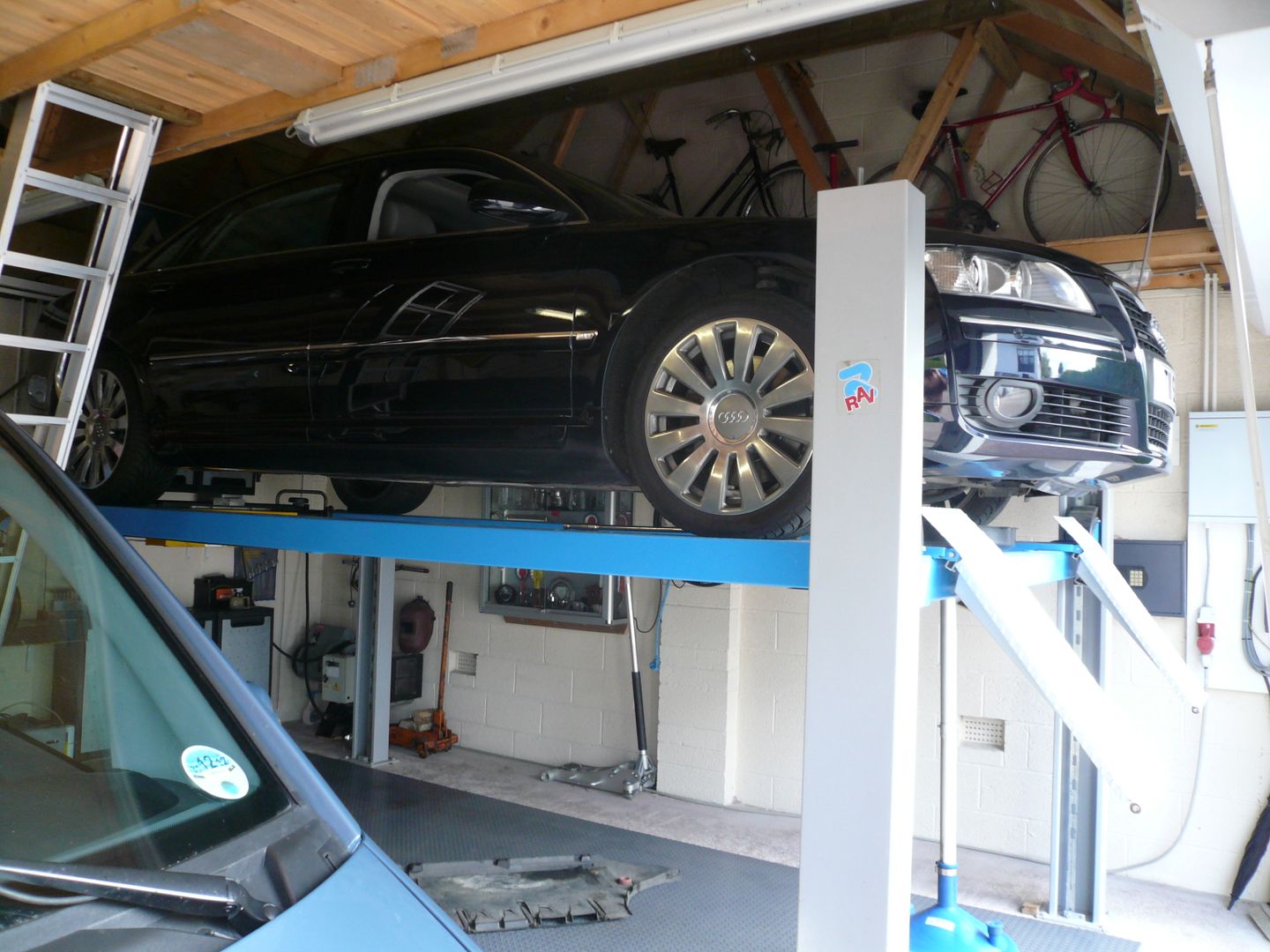

In the air and oil draining

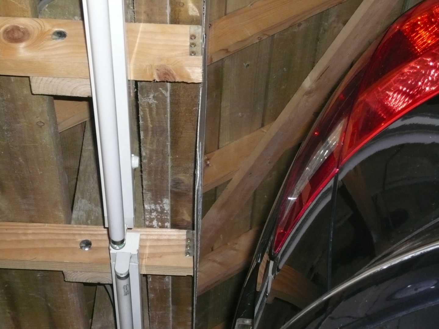

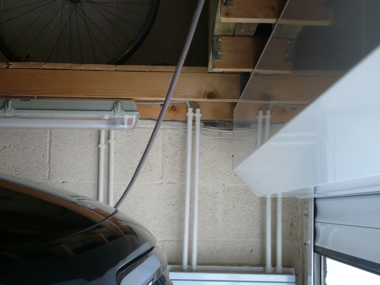

Not a lot of room for a LWB up here...The guys at the Mini-Meet will remember the rope trick

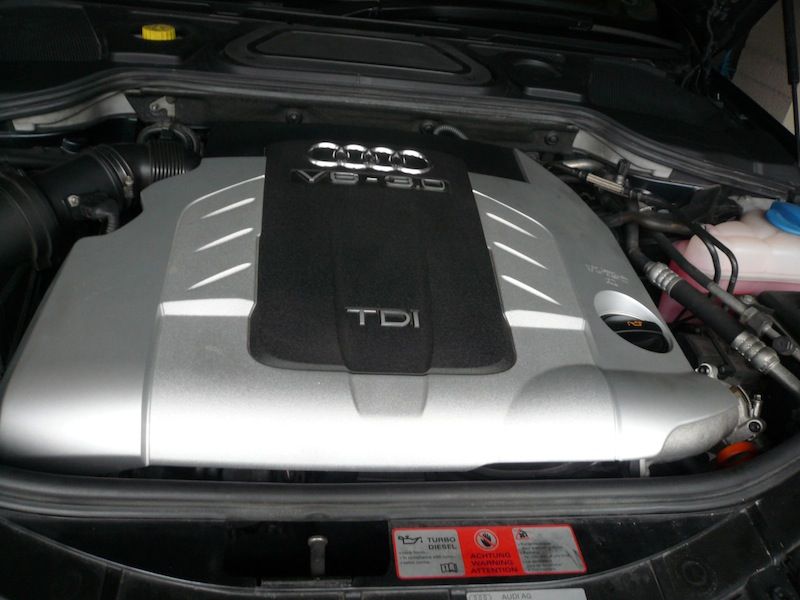

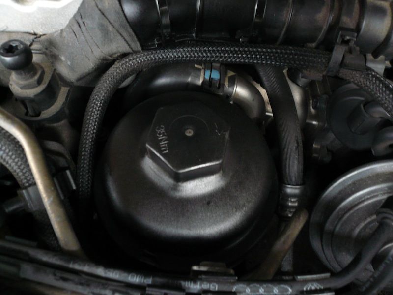

The oil filter is sited under the engine cover
32mm socket required

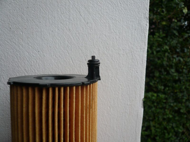

Oil filter has a small extension which has a seal on it, this faces downwards and locates into a hole at the bottom of the filter housing

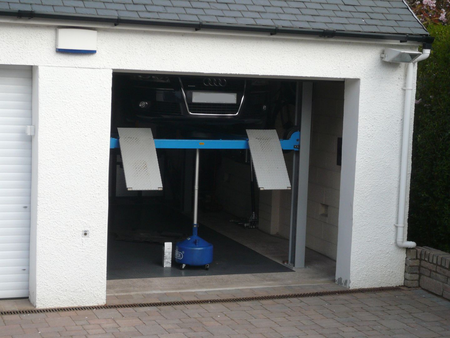

All finished
