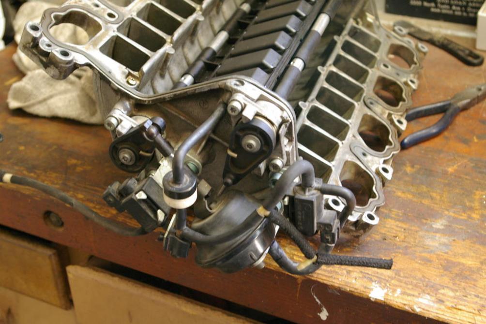

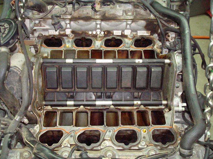

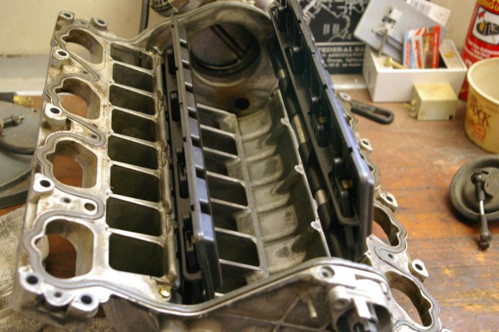

here's pic's ben, it's made by pierburg, from kolbenschmidt pierburg who make the long block assembly's for the a8/s8, i have been researching them for engine block and piston info, was thinking of rebuilding my s8 with rs6 9.5cr pistons and rods as bore/stroke and crankshaft are the same (except for 10 bolt flange on flywheel end of rs6) and would work well with supercharger's that are out now in the states, what do you think? maybe will start a thread for it as i have been gathering online info for years. i know mike, tony and matt are interested. this all, is of course when the A8OC syndicate wins the lottery, by the way the intake arms can be bought here, http://artisans.homeunix.com:443/ for $50, john

Seems to be working now..... I will try the manifold pics, although they're about the same as the others posted, but atleast me "security pass thingy" is seemingly working!
