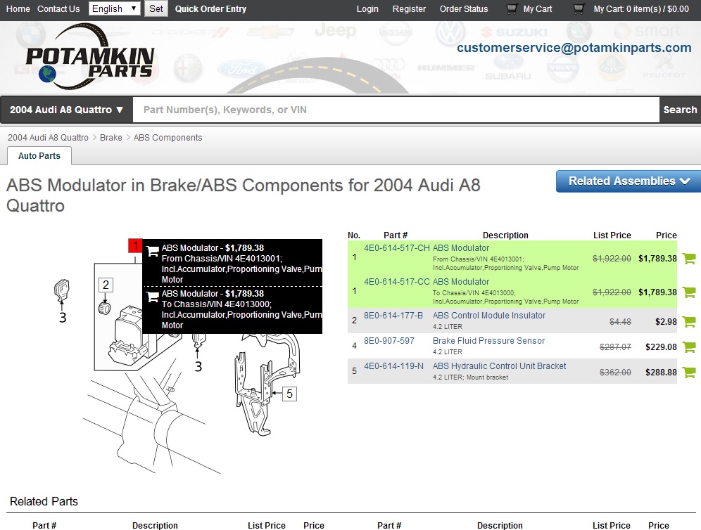

There is a CH as well as CC for 4.2 petrol (LWB)
