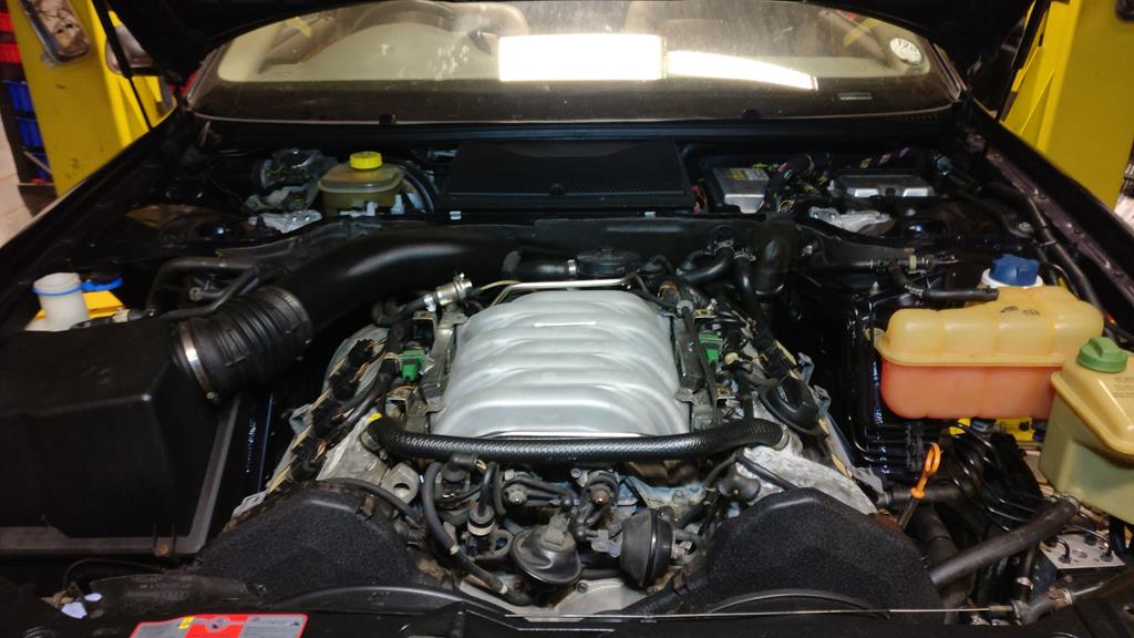

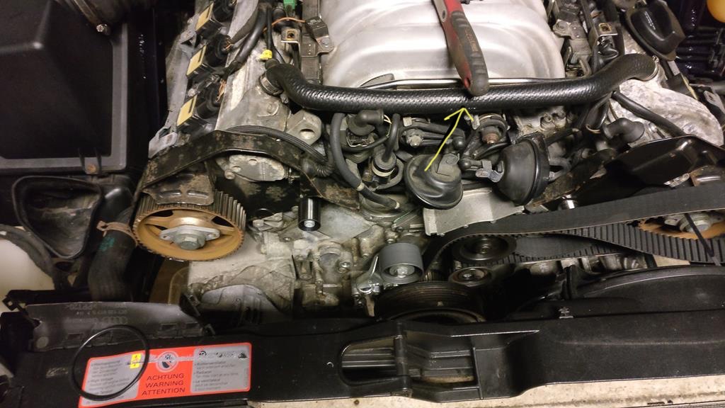

Is that a new cooling hose? Or just another proof of your attention to detail?
If it is indeed a brand new, where did you buy it?

Do you mean the one on the top? Thats a crankcase breather hose. I just cleaned it

That is the one I meant, yes. It looks so good, I couldn't decide if it was new or not. Although I suspected that you might have cleaned it. No-one beats you when it comes to the effort and skill.
Good to see the hose in good condition, even if it's old.

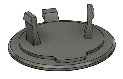

I found another plastic part which is NLA, so of course I just made a new one

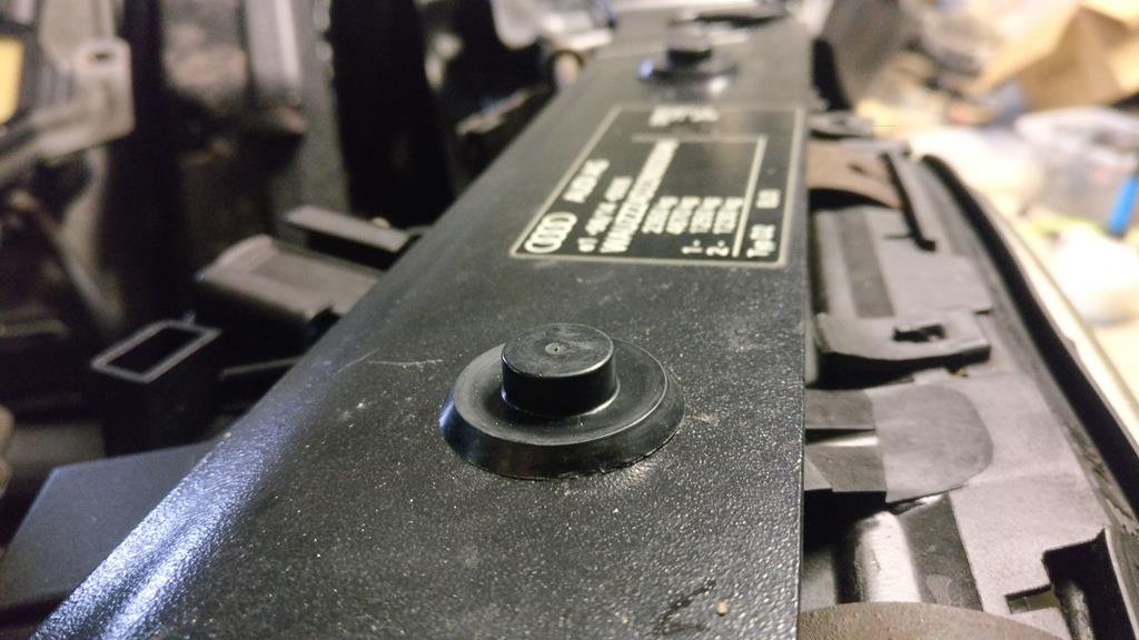

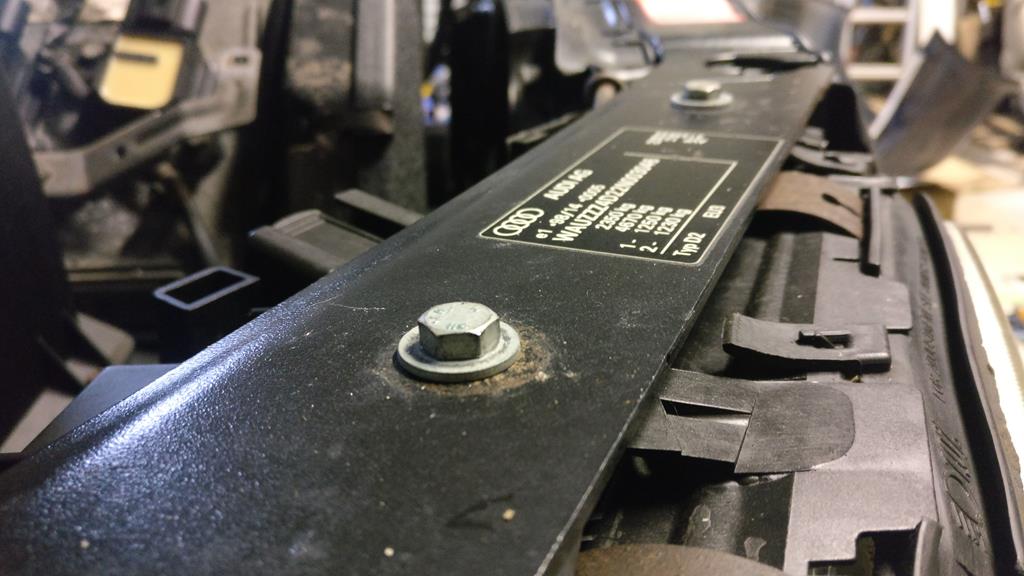

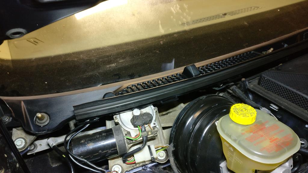

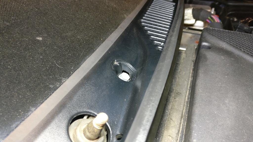

That's it Now I have many of them

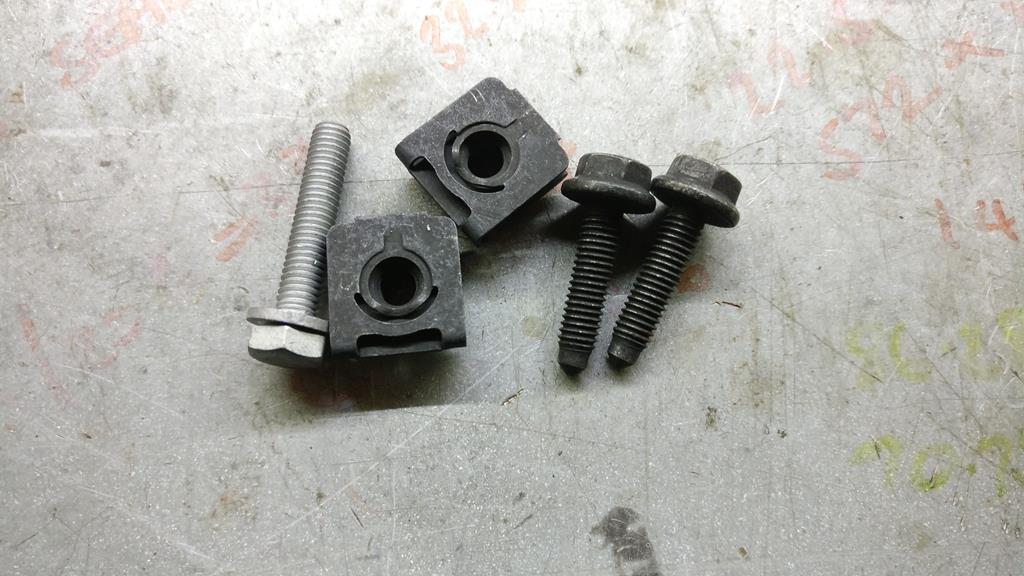

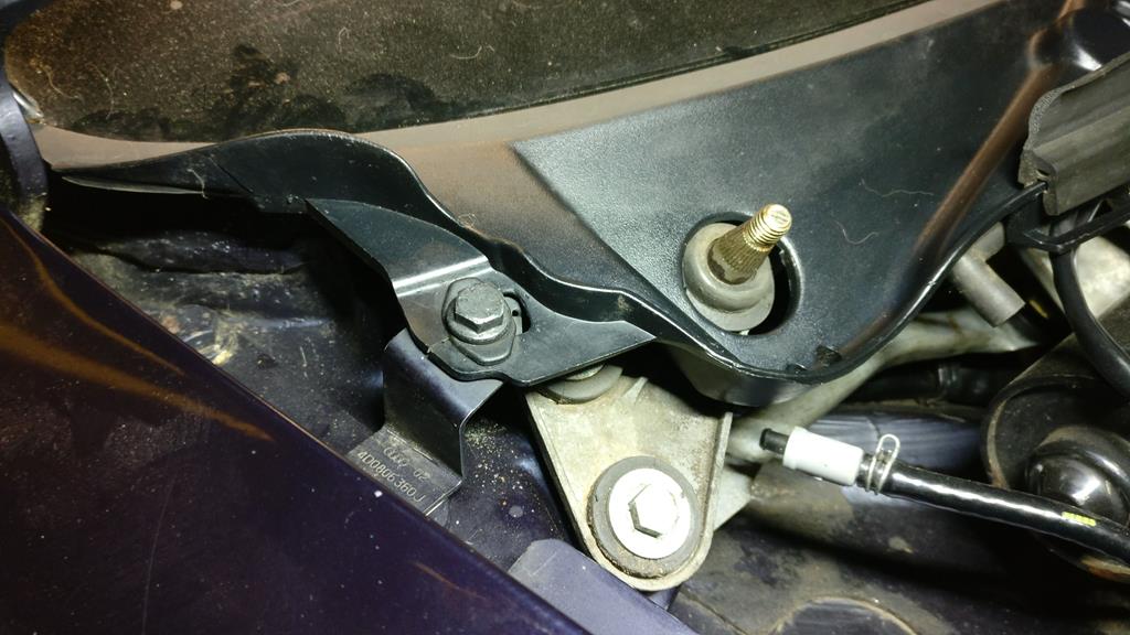

New hardware for the scuttle trim. The original outer bolts are NLA so instead I am using N10160204 which is a couple of mm longer but still has the black coating.
The snap nuts are N90342504 and the centre bolt is N10205604, both still available.
Engine all back together with a new thermostat
The original scuttle trim had been butchered by whoever hacked up the electronics box so that was replaced
New bolts in place

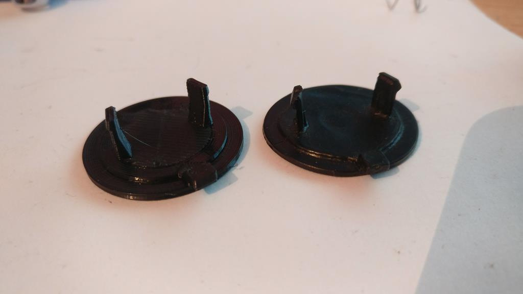

3d printed bolt cover

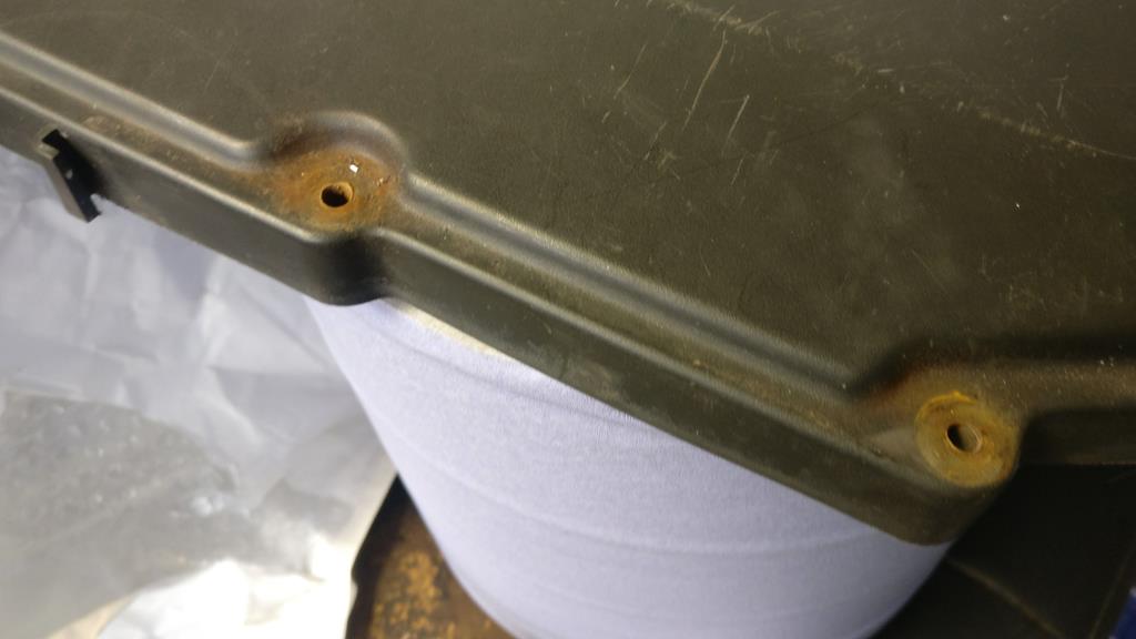

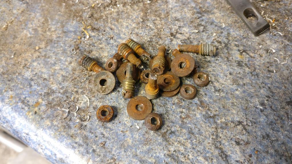

Every single screw on the electronics box cover was trashed so I just drilled them all out
Pretty gnarly but it cleaned up fine

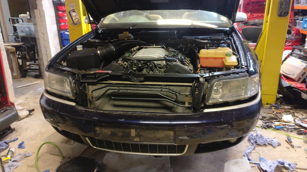

I have run out of replacement hardware for the headlights and I'm not sure if the parts are still available until Monday. It was vexing me terribly to have to use ordinary bolts
Until of course I remembered Sergey's wing bolt covers
Bumper back on
I solved the leaking brake hose issue but didn't take any pics. It was a tiny burr on the end of the hardline flare left over from the previous hose which was stopping the flare from fully seating in the new hose so I filed that off and replaced it and now it's fine
Arch liners back in and wheels on tomorrow and then a quick road test
