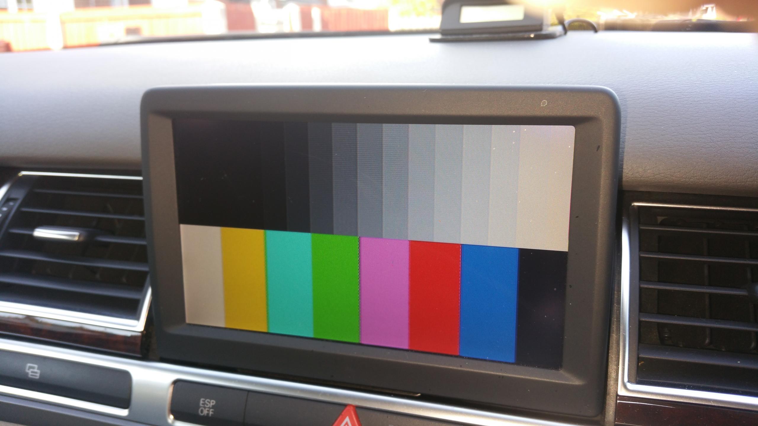

Took the car 100 yards and cleared the old mill building obstruction. Took the following whilst watching BBC 1.
Note that Ant 4 is showing "0".
Whilst moving all four aerial readings changed, number four actually reached 57 at one point. I have "video in motion" enabled.
