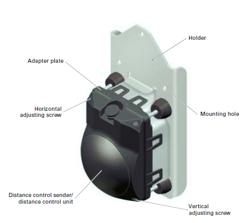

Now go ahead and mount the Radar to the bumper beam, it can be done with it in place but for all the time it took to remove it, I chose to do it that way.
Its just two 18mm bolts either end and remove the horn bracket from the mounting giving you easy access to the three mounting holes for the radar bracket.

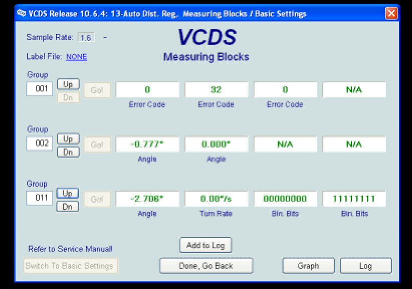

Once you have the cluster in and CP removed you will need to carry out the coding on the various modules required.
The Gateway uses long coding,
Open module 19-CAN Gateway
click on "long coding helper"
In the popup window, using the down arrow on the keyboard press it enough times until you are at byte 4, then check the bit 0 box for [13] Distance Regulation.
Press the escape key, that will copy the new coding to the new coding box
Press Do it!
The Control head [07] has to be adapted to have the adaptive cruise control menu in systems on the mmi
Open the module 07-Control Head and press adaptation button, then from the drop down choose Installation list 1 then hover you mouse over the value box and the helper pop up will appear like below, using it add 1 to the stored value, press test then save and close the controller.

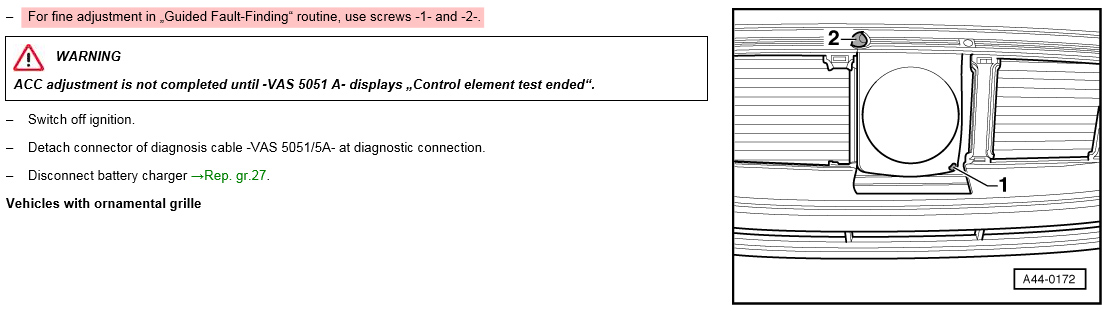

Unfortunately the radar has no label files so, but you can download the attached text file and save it into the User folder of your ross tech labels folder, then re-save the file with the ext .lbl and have the various measuring blocks you need when you open VCDS.
The picture below is of the measuring blocks that are of importance
Group 002 block1 is horizontal alignment and block 2 is vertical alignment.
Group 11 block 1 is Steering angle sensor. and group 11 block 2 is lateral yaw rate offset.
According to elsa both the beam alignment angles have to be 0.5 degrees or less to function error free.
I had readings of over 2 degrees after a run, but on the next run out it was less, I think it relearns on every drive so the readings may be way off if you journey had a lot of bends in it.
To clear the values one must perform a basic setting to allow the radar to relearn the offsets.
Do this by selecting basic setting then press the go button next to 001
Then press the on/off/next button twice
Then manual change the group value box to 002 and perform the same steps
Repeat this process for 003 and 004
Press Done,Go back and close the controller
Ignition off wait for a bit then go for a drive and see if it works.
I suspect group four has to do with different drivers setting but either way I performed the basic settings on it too.
