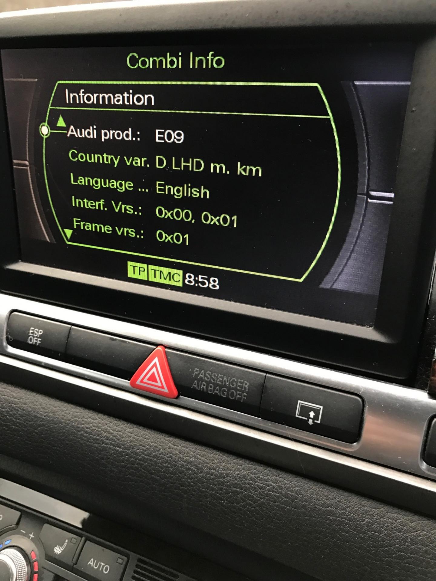

Originally Posted by JulianHicks View Post
Speed_Demon; am I misunderstanding something here?
There isn't a specific setting for MPG; I presume this is set from the units in the Car menu.
Julian
Hi Julian - I can`t see an option for changing the units in the car menu at all. Only get a few options to change like speed (in mph or km) etc.
In the instrument cluster the fuel consumption is displaying as xx l/km (l/100km) which I can`t seem to change.
In the hidden menu I get this under the MMI settings (see attached pic)

Hi Julian - all of those settings are set correctly from what I can see. So will probably need a VCDS scan to see what the root cause is. There doesn`t seem to be any other option in the 'normal' car menu system for me to change the fuel consumption figures so I think it must be linked to my car seemingly being set-up as a LHD in the software somewhere with the door issue I have in the cluster and also the LHD set-up I can see in the green hidden menu under MMI.

Old 15th February 2017, 08:29 AM
So, you have the latest MMI version which is good, at least we know its not the MMI software glitch.
Now, if you can access green menu, go to DIAG SETTINGS and untick linkslenker which LHD, if its not in in DIAG then check all the other menus and submenus please.
Hi mate - have unticked that option already to no avail. Spoke to my local Audi who said the instrument cluster has nothing to do with the MMI (W.T...?) So does not give me much confidence. The car is in with them today for a free health check and looking into this issue I have so will see how it goes.
