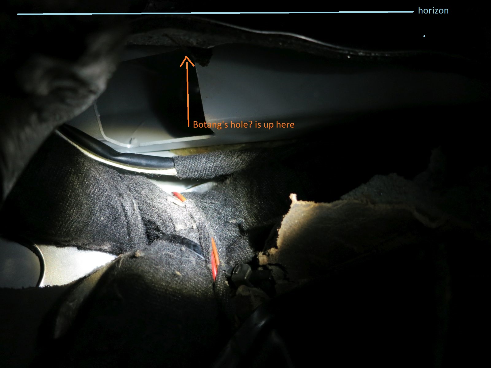

That "duct" looks like the main beam that I have seen that goes right across the car inside the dash structure.
Could Botang's hole be the leak?
That's what I was worried about, if that beam goes accross the whole car the leak could be somewhere from the middle then trickle down all the way to one side or the other.
Could well be Bontang's, Worth a dig around for reasurance.
I'll have a look under the ECU box, its on the right side for me.
Botang's hole IMHO
Same location on LHD and RHD cars
If that's so, then it definitely doesn't exist on LHD cars, because that area is occupied by the pedal box cut-out, and the area between the pedal box and aircon heat exchanger box in the middle is clearly visible and has no other holes.
I am going to have another look tonight with a borescope camera, first by going along the inside of the duct to see if that reveals anything. My suspicion currently is that its something to do with the huge middle box containing the aircon flaps and heat exchanger, that goes through a cut out in the body doesn't it? Plus it has the scuttle drains below it. Sounds like a potential problem area.

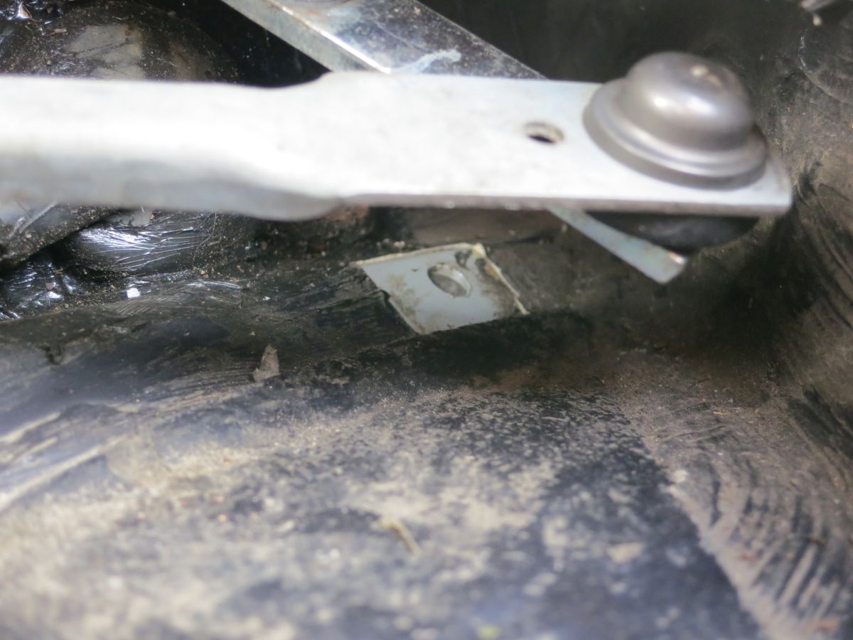

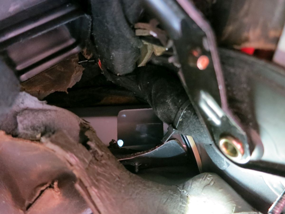

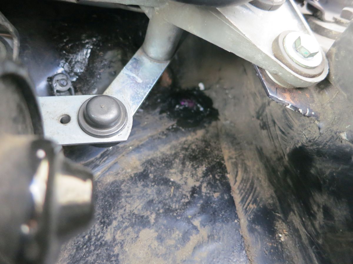

Post a picture how it looks like from the top.
It does (!) exist on LHD cars.
Old 12th July 2017, 09:53 AM
Pics for LHD cars:

Old 12th July 2017, 10:13 AM
That's it! Exactly the same location. I will post a pic before I plug it. I never new Botang's hole was there, I thought it was further down closer to the middle.
What a nightmare!
The location is pure genius, it is positioned to trickle water down several wiring looms, drip onto relays and onto a group of earthing points on the chassis!
