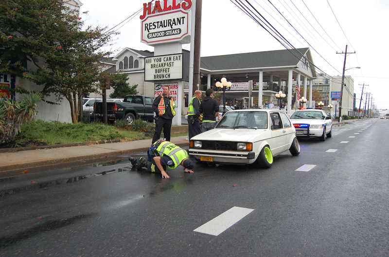

Mine will stay as is, although it would look good with negative camber on the rear.
I’m surprised none of you guys track daying your cars have tried it.
Are the S8 control arms longer than the standard 8’s to allow for the lower suspension or is it not enough to make a difference to the camber.
Here's a Golf with plenty too much
