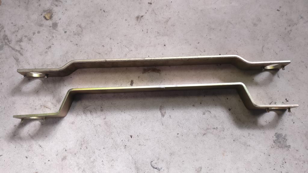

How can the V6 and the V8 be telled apart?
The V8 bracket is shallower. I'll get a pic of both side by side this afternoon.

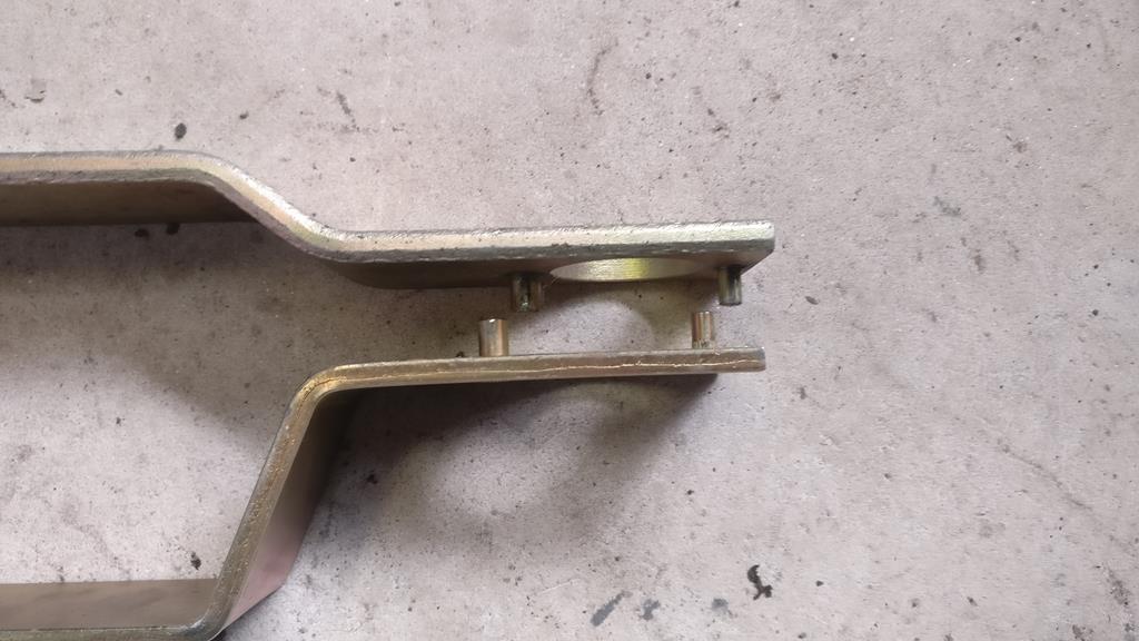

V6 (bottom) and V8 (top) locking bars:
The V6 bar is deeper to clear the power steering pump, and slightly shorter:
There is an adjustable bar available in the US I believe. Never seen one of those here though. Its easier for me just to have one of each anyway.

Thanks for the comparison between the two. this is the adjustable one that's available but it's for the V6 engines. I'm guessing it won't work with the V8 engines?
Old 27th September 2020, 09:45 PM
No, it'll be too short. Odd to design it just for the V6 actually - if they'd made it 1cm longer it would have worked on V6 and V8 engines.
