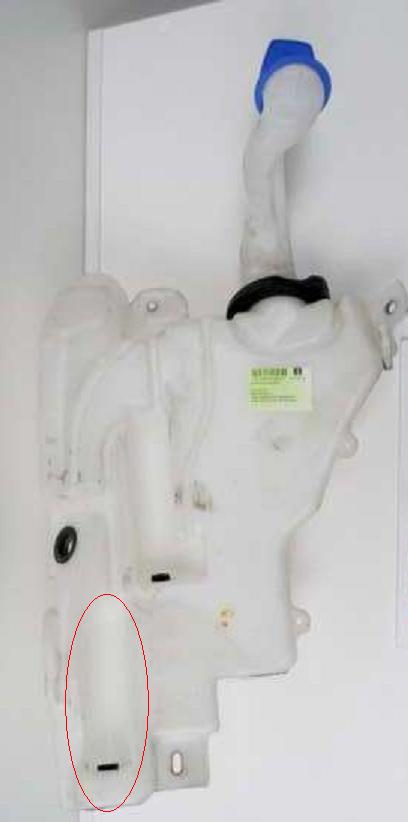

Red circle shows the location of the screenwash pump.
Is it sorted now??
