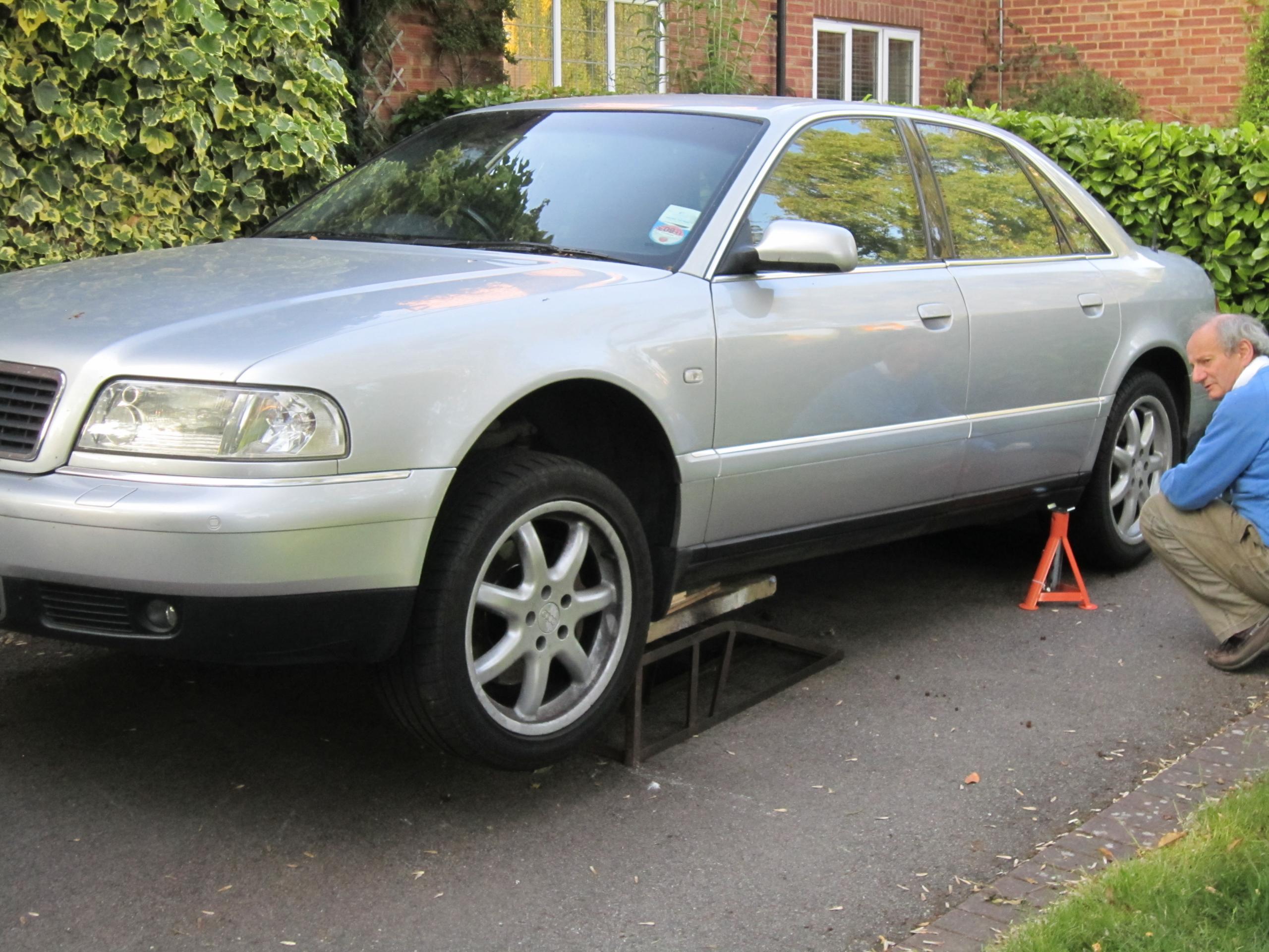

Old 15th August 2014, 02:22 PM
I also did this job with a trolley jack. Also found it annoying I could not fit a stand under the car when jacked up.
Hopefully you can re-wind the caliper easily, one of mine was stuck because it came out too much (pad worn to metal) so it turned out into a bit of a nightmare having to replace the rear caliper.
Old 15th August 2014, 05:03 PM
sarg sarg is offline
Posts: 2,087
I don't recall how I got to this point, but it can definitely be done
Name:	Gearbox oil level & type check 001.jpg

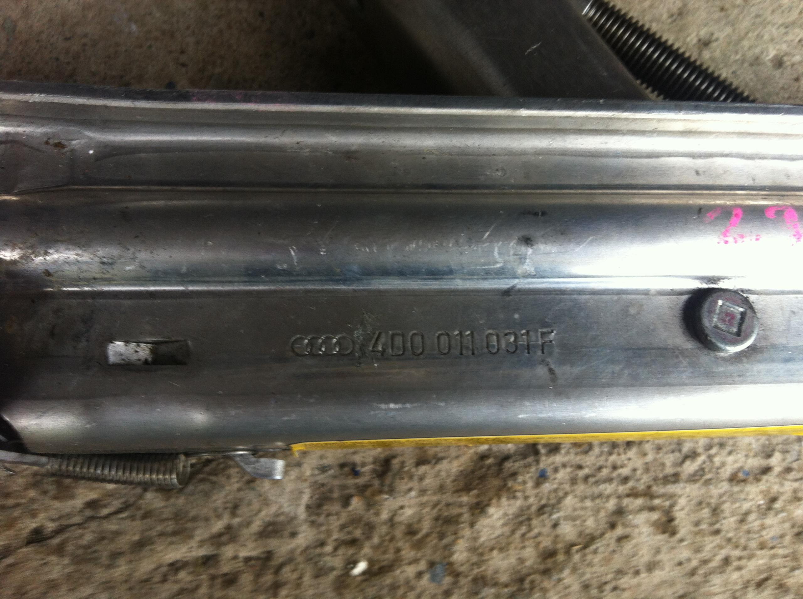

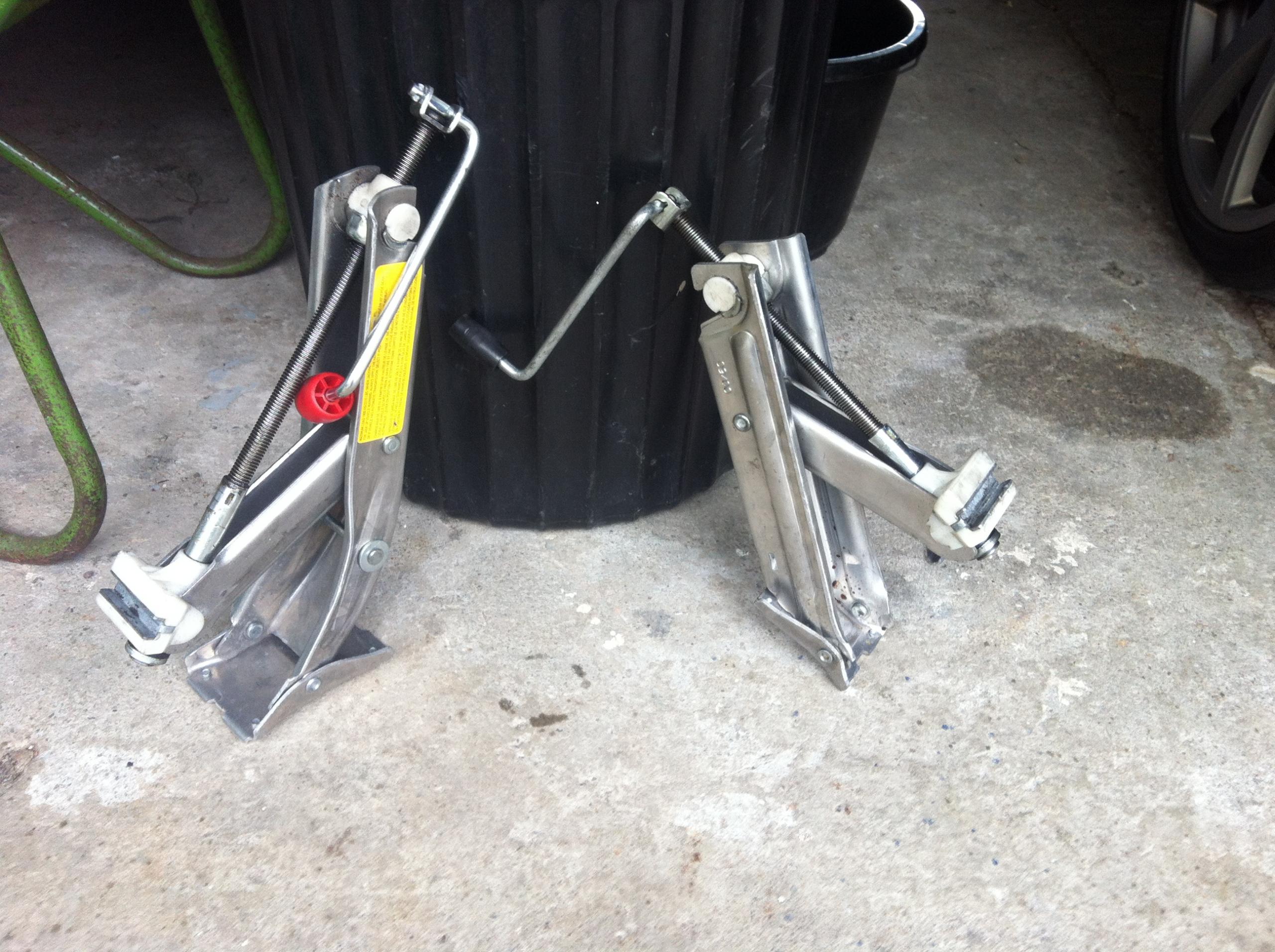

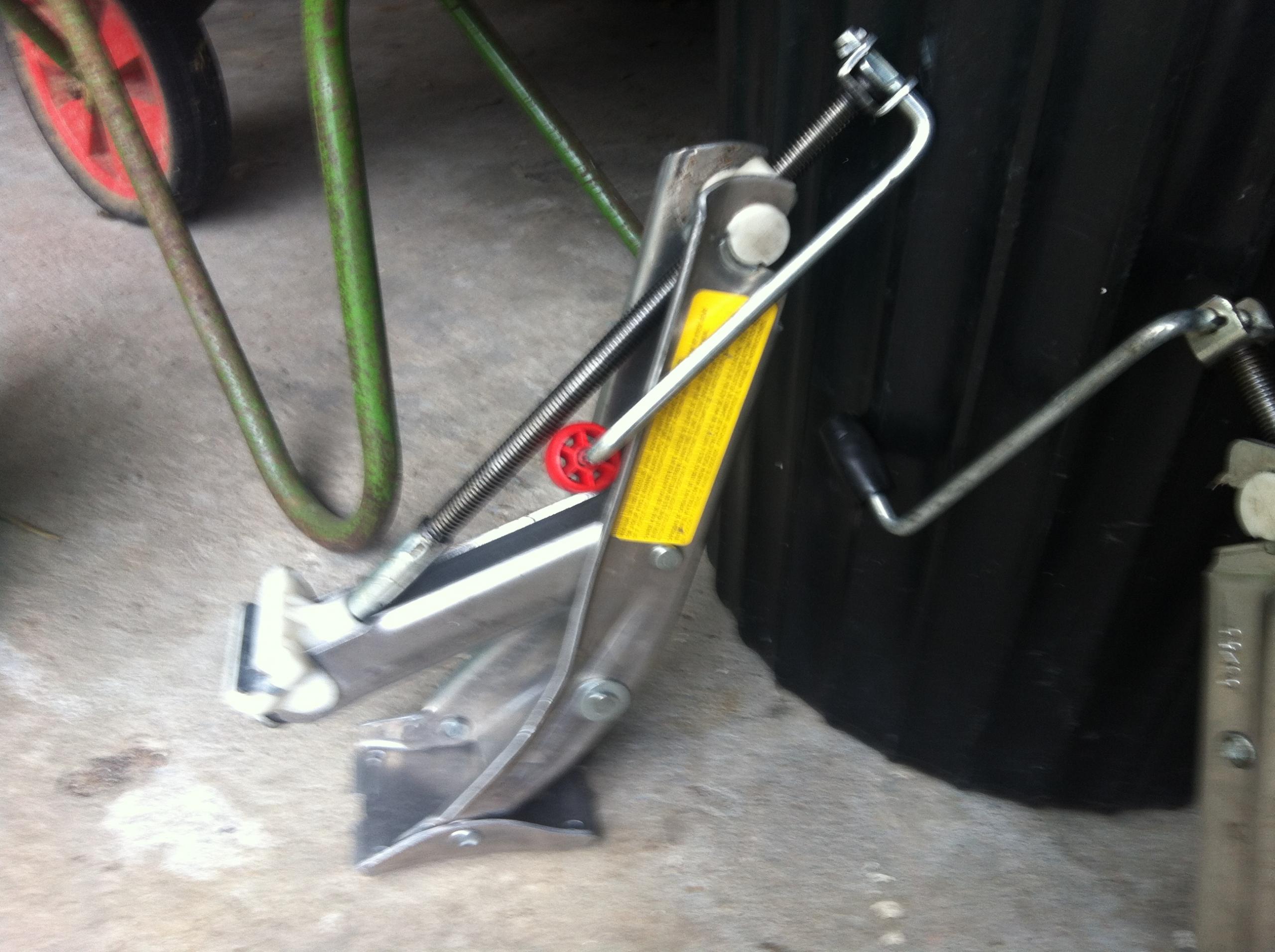

Old 16th August 2014, 03:14 PM
Here are my 2 jacks. You can clearly see that the 'heavy duty' jack is more 'chunky'. Mine is part number 4D0 011 031F

Old 16th August 2014, 04:21 PM
jools_s8 jools_s8 is offline
Join Date: Aug 2014
Location: West Cambs
Posts: 40
Thanks again for all the replies.
I sized up the brake job again and given my driveway is on a slight incline, I bottled it and will get my local mechanic to do it, which will cost about £50, assuming they are not seized.
The rear discs are going but not unsafe. Agreed, the factory jack looks underspec'd
