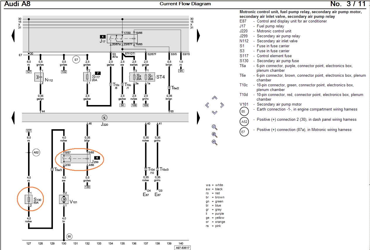

Hard to say from video but it could be secondary air injection pump if the noise come from air filter box area in which case you could just temporarily disconnect it. If you have VCDS you might be able to test it using output tests or as Audi call them final control diagnosis.
Any idea how to disconnect? Plug seems to be behind air box and I can't get my hand in there! Does air box have to come out first?

Ah, yes, sorry I forgot about the rubber tube. It is a press fit into the airbox and would have to be taken off the SAI motor unit from inside the airbox. Its really difficult to squeeze through that hole so not worth it if there is a easier way.
I wonder if there is a fuse in the fuse box that only relates to the SAI motor? That would be a much easier way to temporarily disconnect it.
Old 4th January 2015, 04:45 PM
Posts: 3,854
There should be a fuse somewhere, not sure where. There is relay for it in electronics box in plenum chamber, fuse might be next to relay.
Guess I need a fuse diagram now
Old 4th January 2015, 05:11 PM
I think I found it, should be fuse S130, a 50A fuse. I cant work out where its supposed to be in the drivers footwell on the side, or in one of the other fuse boxes. Maybe I'm being thick I cant find a fuse diagram in ElsaWin, surely there should be one?
Relay should be no. 4 in the passaenger footwell?
