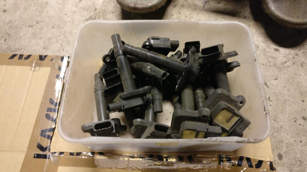

This engine came without coilpacks but I have a few spares from exploded engines

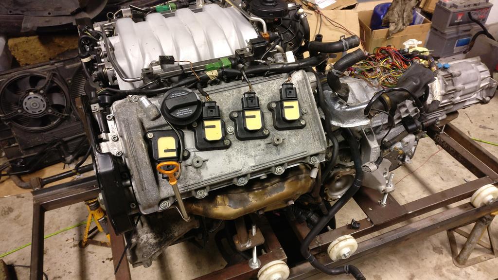

Coilpacks fitted and the wiring harness cleaned up and back in place

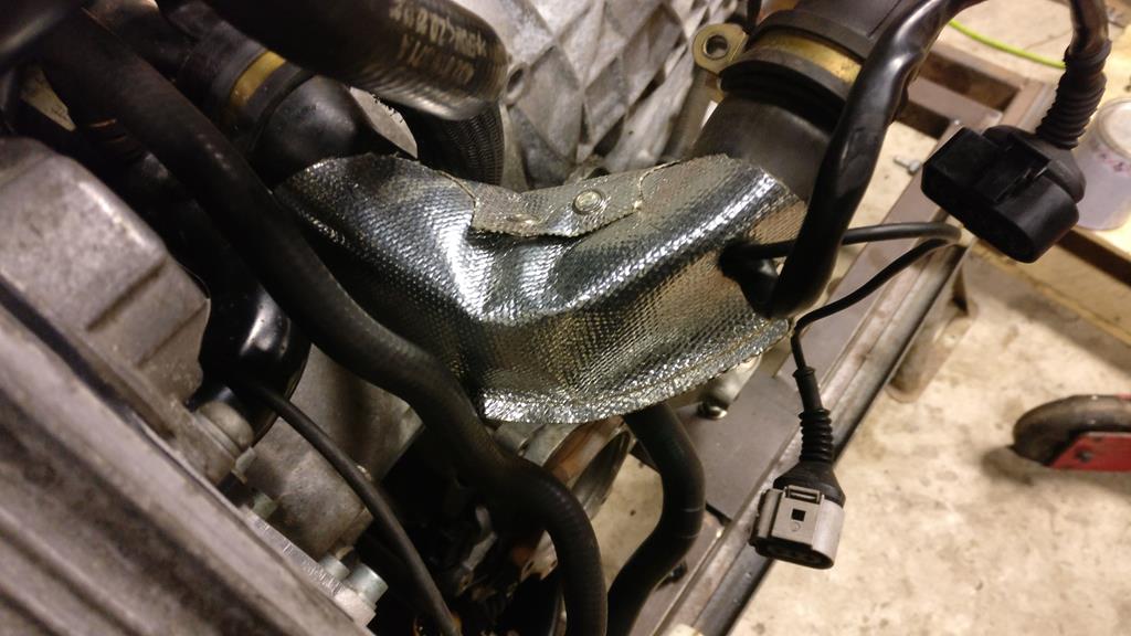

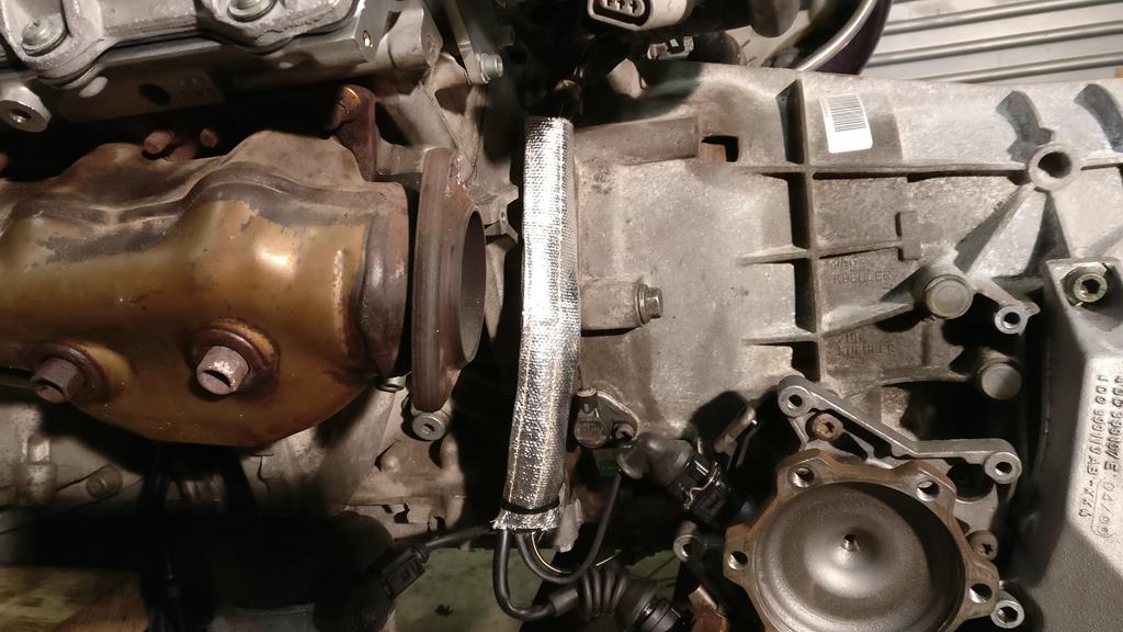

The last ever new-old-stock D2 engine harness heat-shielding. Some cars have shielding over the downpipes and some don't. Not sure why. This one had none at all.
Aftermarket shielding on this side
They should all have shielding here but captain carnage left it off and the exhaust heat killed the pvc sleeving

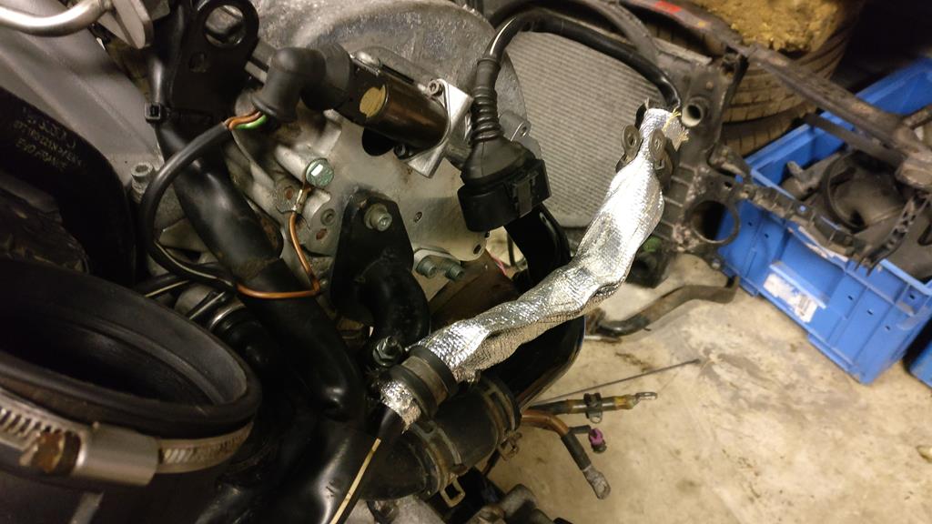

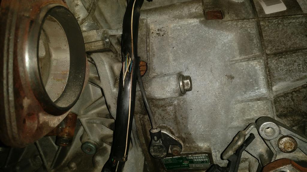

This is the left engine mount connector which has frayed and damaged wiring

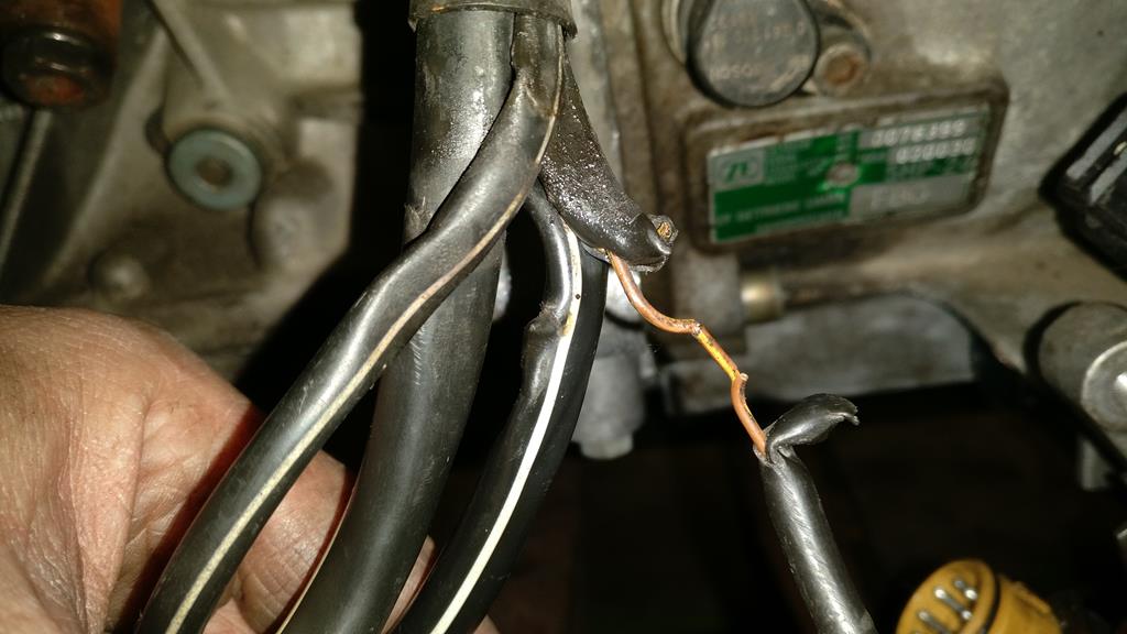

This is the speed sender connector which just broke off when I wiggled it.
I've refitted the harness to the engine before mending these connectors so I can make sure I get the lengths and connector orientation correct. Its as easy to work on with the engine on the stand as it is on the bench so I don't lose anything. The damaged wires and sleeving will be replaced, and this section of harness wrapped with more heat shielding material. Hopefully TPS have repair wires in stock so I can still get the engine in over the weekend...

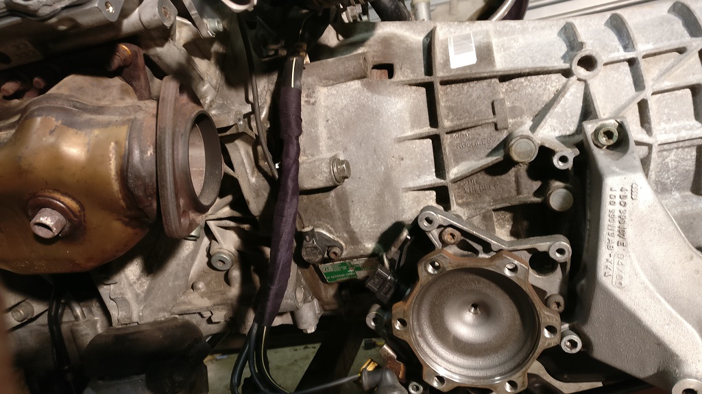

I need some of that tape!

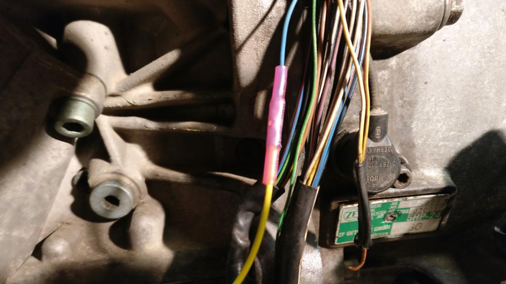

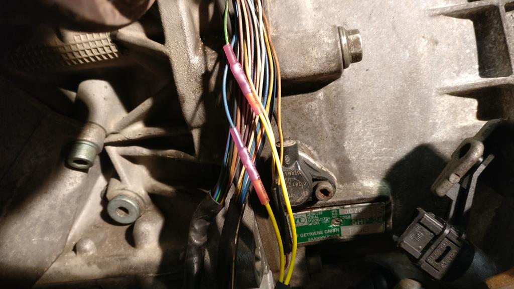

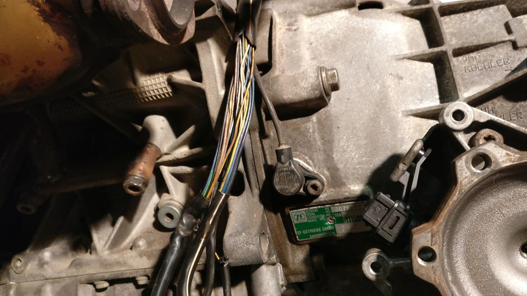

£50 of wires These would have been much cheaper had I remembered they were needed and ordered them in advance
Cut off the burned and brittle sleeving
Attach the repair wires to the originals with heat-shrink crimps
Wrapped the repaired section in fabric tape
and the covered it up in heat-resistant sleeve

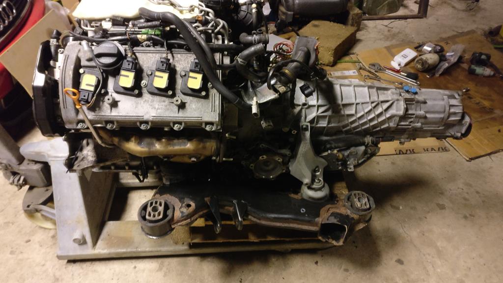

Engine and box back on the subframe

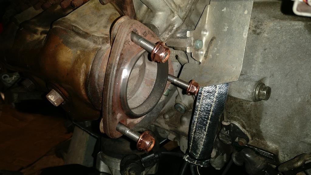

New exhaust manifold hardware
