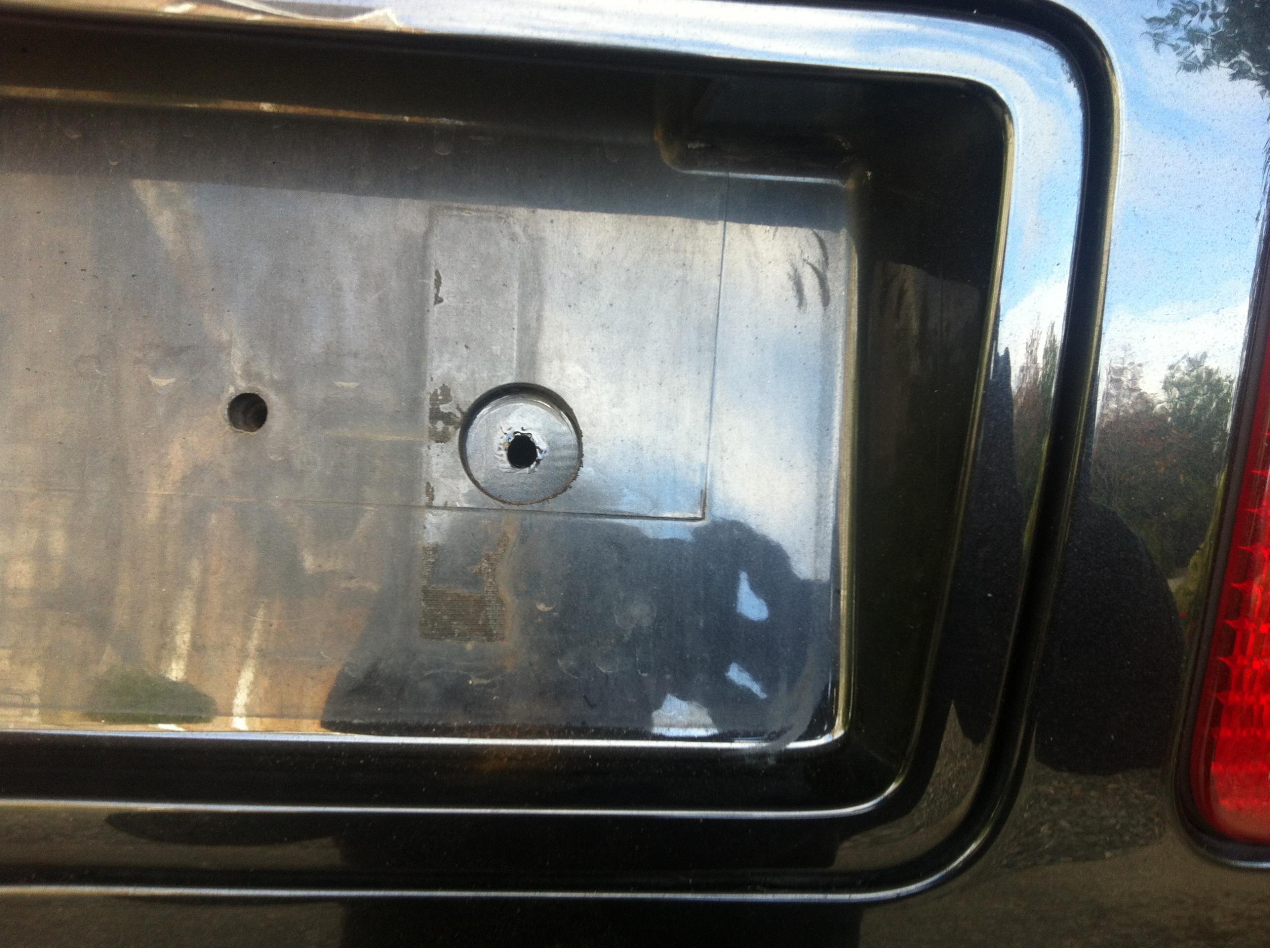

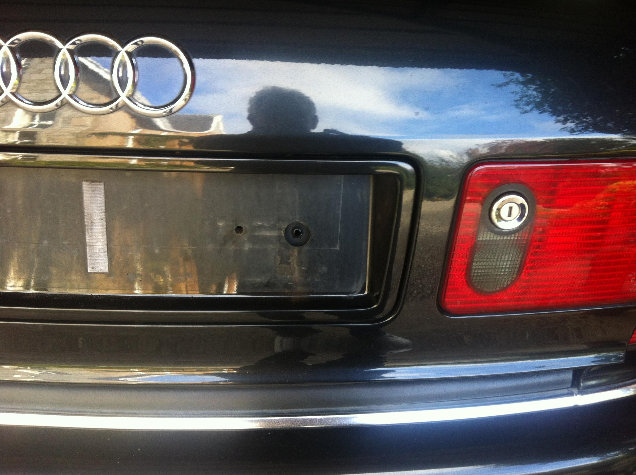

Take the numberplate off and cut through I guess. New boot lid in the end probably.
The numberplate mount is plastic and retained by 5 self-tapping screws (3 top, 2 bottom) so should probably snap off with enough force to reveal the metal sheet behind.
