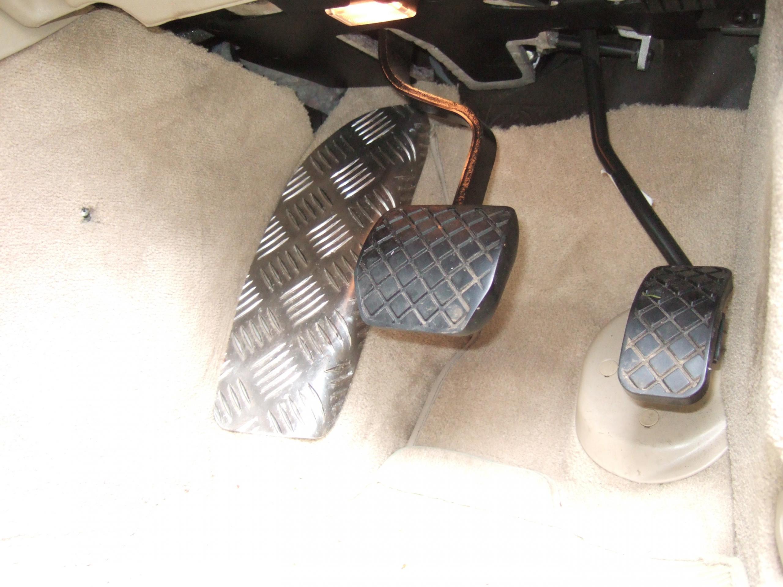

Old 15th August 2014, 08:01 AM
David, I see what you mean now.
If you still got a plastic bit spare I can drop it off to my metal workers and see what sort of price that come up with?
This is what I have currently fitted as a temporary solution. But as stated earlier its too industrial and clunky. One of the issues is that the radius of the plastic footrest (on the D2 at least) changes along the length but keeping to one radius doesnt give too bad a fit.
