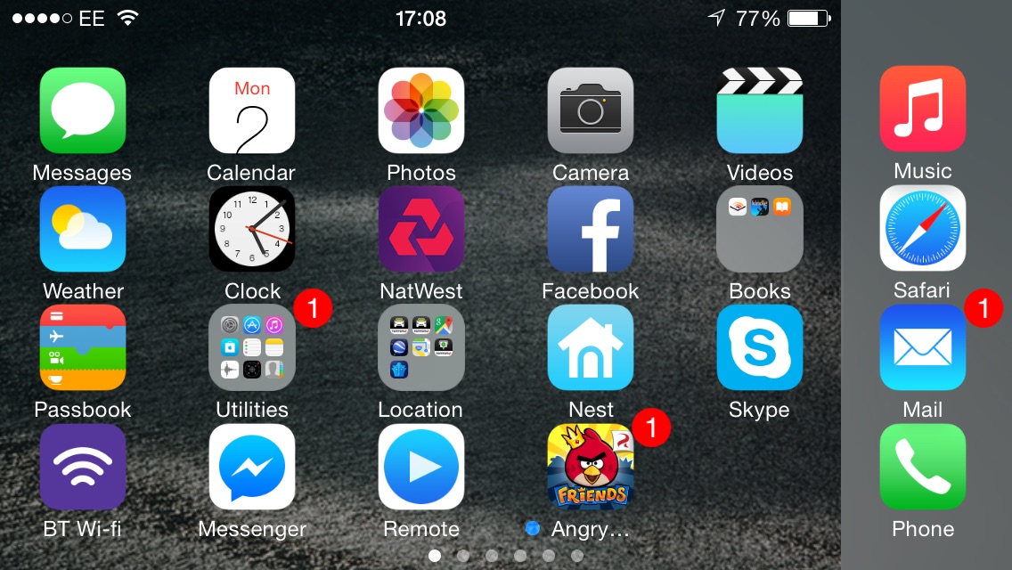

Default So for those thinking about it
I mentioned in the video that the iPhone's native display in portrait was somewhat annoying as the mmi screens landscape.
Well true to fashion the jailbreak community has come good and if you go ahead and jailbreak the iPhone and install an app called sbrotator 8 then you can get a rather nice landscape view that can be locked to prevent it going back to portrait while in the car.
