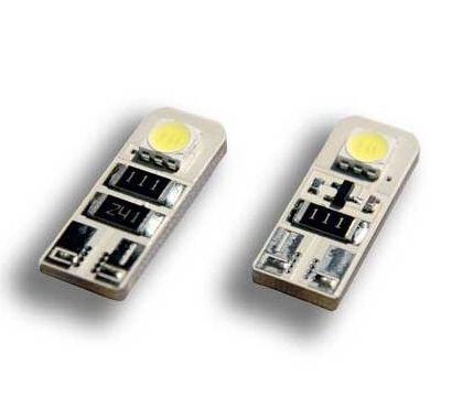

I don't think so, but it so happens that the rear footwell bulbs that physically fit best ARE the one of CANBUS types.
e.g. like these:

  #43
Old 6th February 2013, 06:09 PM
So do any of the interior bulbs need to be CANBUS? I'm really confused about this (not difficult, I know!)
No
