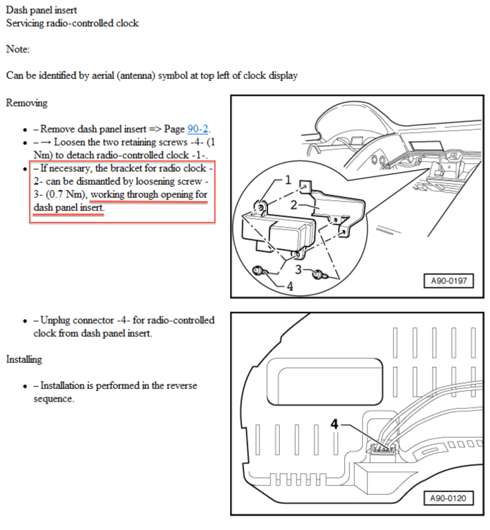

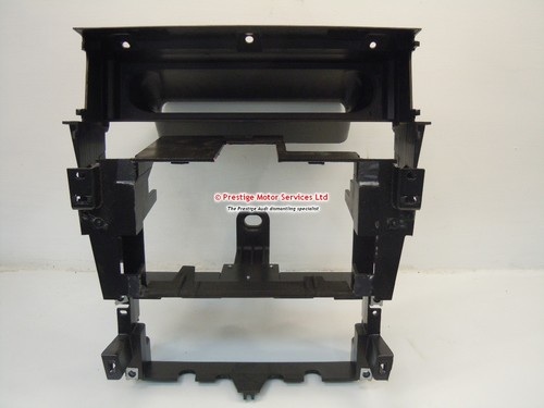

Plan A. Bite the bullet and install in OEM location via centre console. That will involve removing everything from centre console, including 'shelf' for the radio. I'm looking at something like this:
Well, because this thing needs to be removed to get proper access:
Don't want to do that really
Or maybe try to get access to that area via passenger footwell. This is what ELSA is saying about LHD cars. Sounds like a mockery, at it is VERY tight there

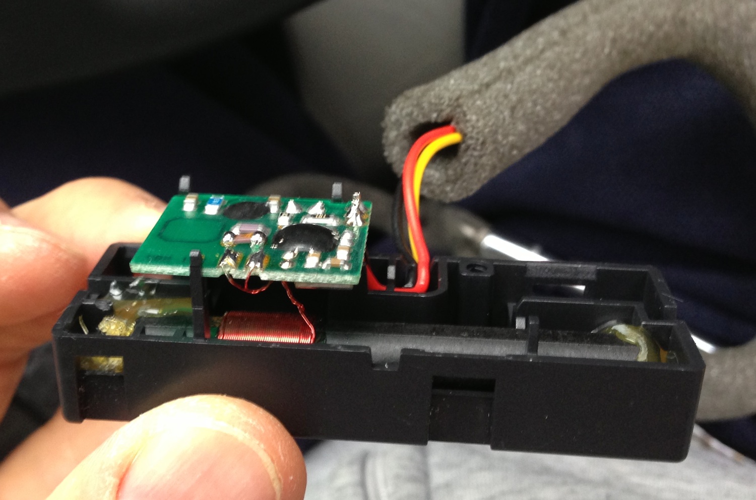

Plan C. Get myself another receiver. My example can be a bit weak. Here's how it looks from inside BTW. Basically, it's a long wave antenna configured for specific wavelength.
