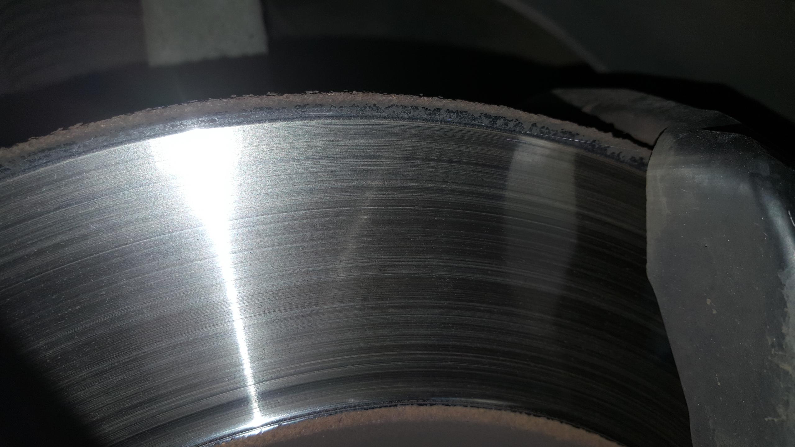

Not that a 390mm disc would benefit. Its purely for looks as you can see the standard 385mm disc doesn't use the whole braking face of the disc. I could even likely go down to a 380mm disc without issue and use the whole disc surface.
might be an option in fairness. Has anyone put smaller discs on?
