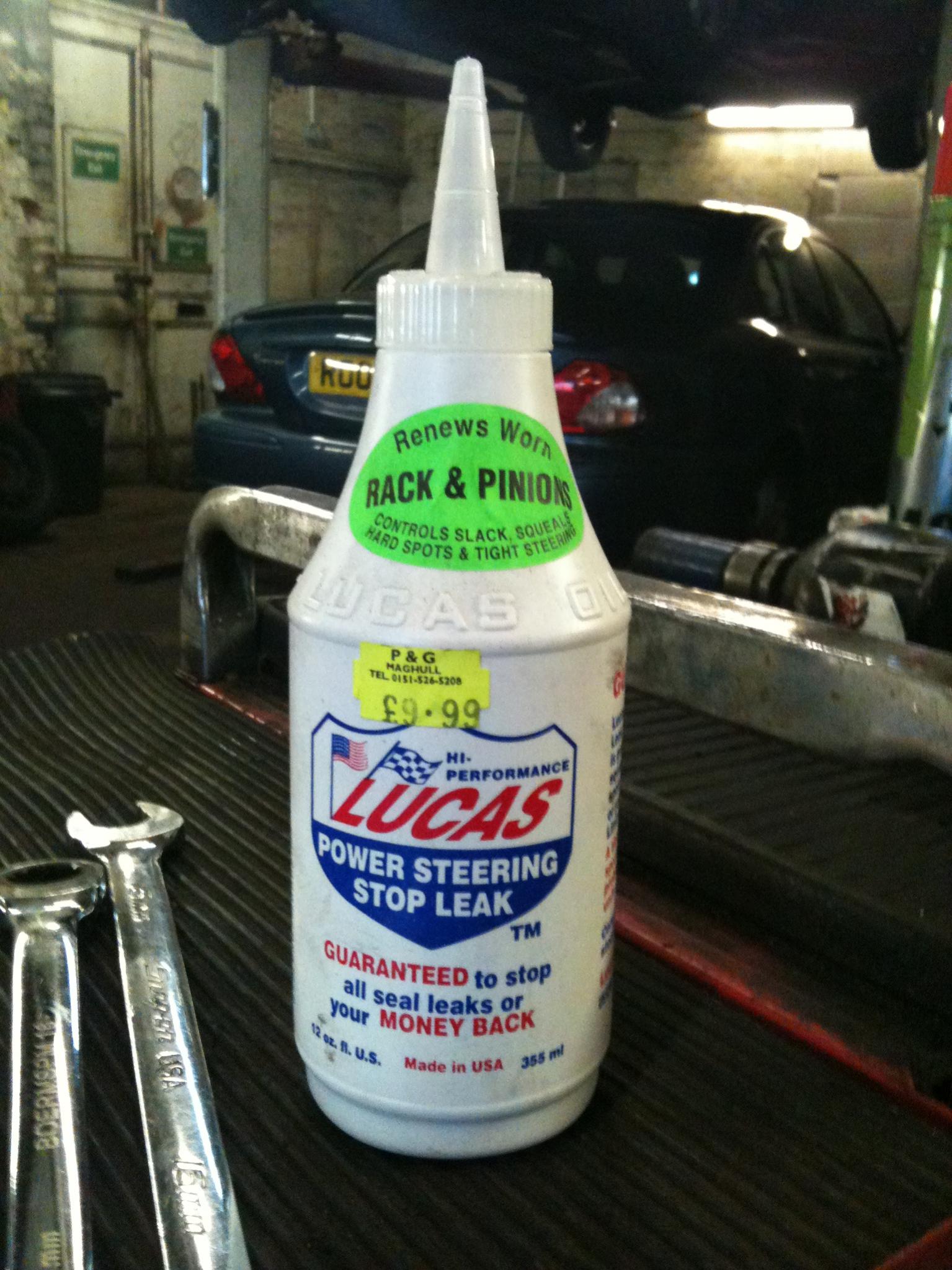

Andy,
You could always try this in the meantime.
I'll try and make the pic a bit bigger next time

Cheers.
Where do you get this from and is it good

I picked it up from the local motor factors.
Is it any good?
Well, it stopped the leak but I don't know if it contributed to the demise of the steering rack. I don't think it did, it was probably just wear and that I have to do a lot of lock to lock low speed steering.
It's worth a punt for a tenner if the rack's knackered anyway.
I'll pick one up for you if you can't find it.
