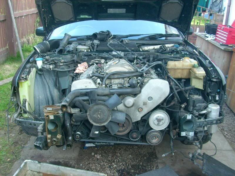

Thought I had better start a thread on the work I'm doing on the A8 currently. I have a tradition of starting project threads even if the car doesn't get finished
Long story short, the engine is mixing oil into the coolant system (potential heat exchanger common problem) As well as it having been off the road for around a year so obviously no MOT currently.

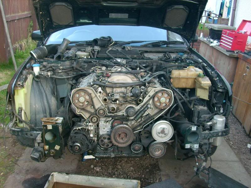

Here's the events of today after a few hours work.

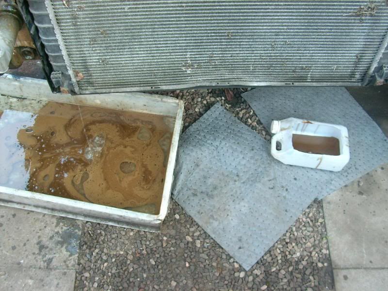

Can you tell which one is coolant and which one is gear oil
After a compression test the engine has come up healthy enough. I now need to do a coolant pressure test and get to the bottom of the mixing coolant.

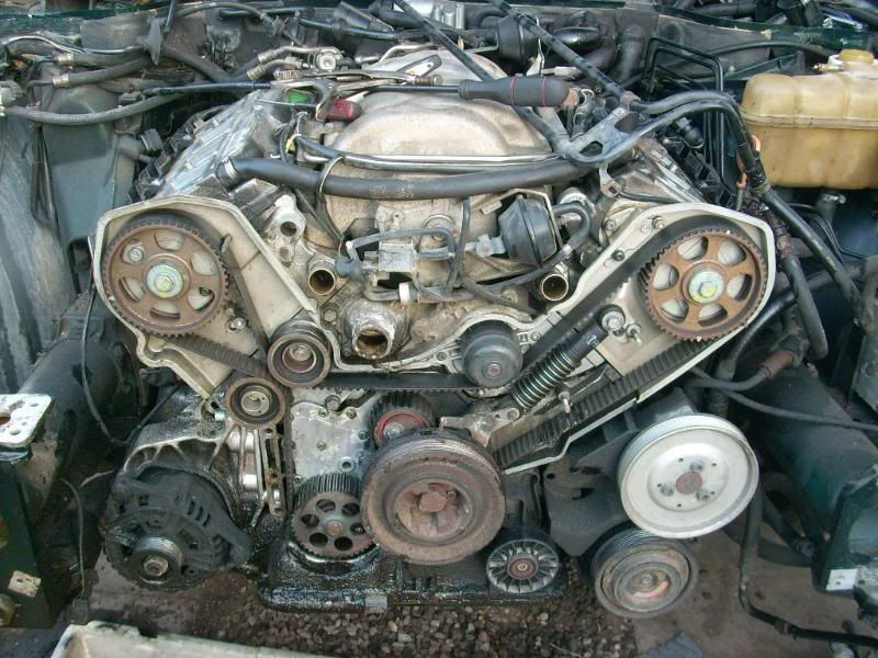

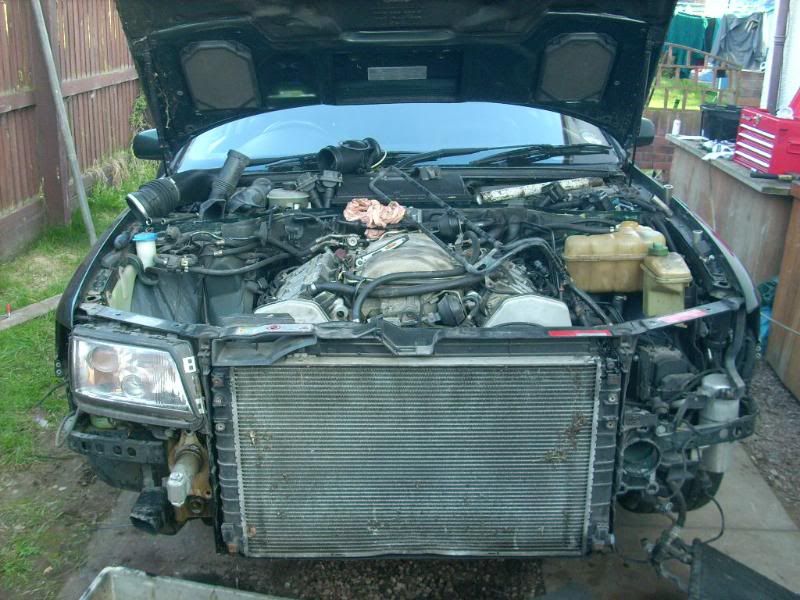

I've also got a bad leak from the p/s cam cover breather, the two exhaust sleeve clamps are knackered and blowing adn the inside is filthy!!
More to come through the week when I steal the coolant pressure tester from work.

Looks like you've got all angles covered. The plastic coolant pipe is a well-documented weak point. I would get an aluminium replacement whilst you're in there, even if it looks okay.
Probably a good time to do a timing belt kit, water pump and thermostat replacement, having come this far.

There's a plastic pipe that carries coolant from the cylinder block to the oil cooler (just behind the alternator, incorporating the oil filter). The pipe is sandwiched between the engine and the oil cooler itself, only visible once the cooler / oil filter assembly is removed.
This pipe cracks, as it becomes brittle with age, resulting in coolant leaks. It's a bitch to replace with the front of the car in place, with your front end stripped as it is now, access and replacement is cake.
