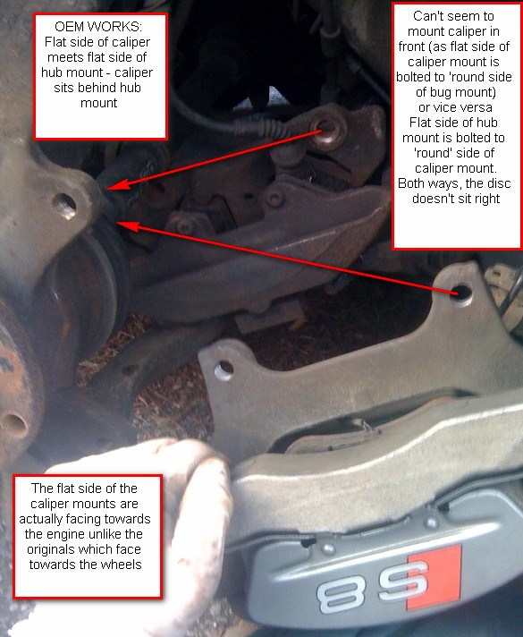

Is the distance between bolt holes the same?
Yes it is
The caliper should fit behind the Hub mounting points as the hub has the thread that the bolts fit. If the caliper is to far towards the outside of the car and doesn't centre on the disk you can use shims to move it inward.
If its to far in then you will need a bracket to off set the mounting point. Unless it is only a millimetre or so then you could machine the calliper mounting points.
I think the issue is that the hub mouting points expect a caliper to fit behind it but the D3 calipers that i have bought seem to have a flat side that would indicate that you mount it 'in front' ofthe hub mounting point.
I've tried to explain in this diagram...hope it makes senses (note top right comment should say 'hub mount' not 'bug mount'):

You may be able to cobble together a bracket, but I do know that some A8s have a different hub and caliper setup from others. PaulW fitted Porsche brakes to his, but he did have to have to get some brackets manufactured.

I had a chat with Ben and he's convinced he can engineer mounting brackets to make these fit so I'm dropping the car off with him in a month.
