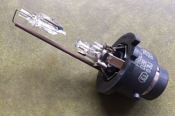

Edit: Job done, all fitted and working well. Bulb had exploded so my offside light unit is full of broken glass and metal from the shutter.
Not sure if I can somehow suck that out through the bulb fitting hole with a small tube attached to a vacuum cleaner or will need to dismantle it.
Is dismantling a reasonable job?
I did remove the air intake pipe but that only slightly blocks access for the H7 and probably makes no real difference.
Maybe a bit of "vigorous" driving will shift the debris out of harms way?
Hi Andrew
Dismantling is relatively straightforward, but the unit does need removing from the car before you can take the lens off. It's covered in the refurb thread I did on the bi-xenons.
It would probably be wise to have the alignment checked after refitting as there's reasonable movement on the fixings.

Thanks Adrian, I'll save that for the summer unless I have a problem meanwhile. My lenses are OK so no need to dismantle to clean them.
The hovering method isn't feasible due to metal shielding blocking access; I did try....
  #29
