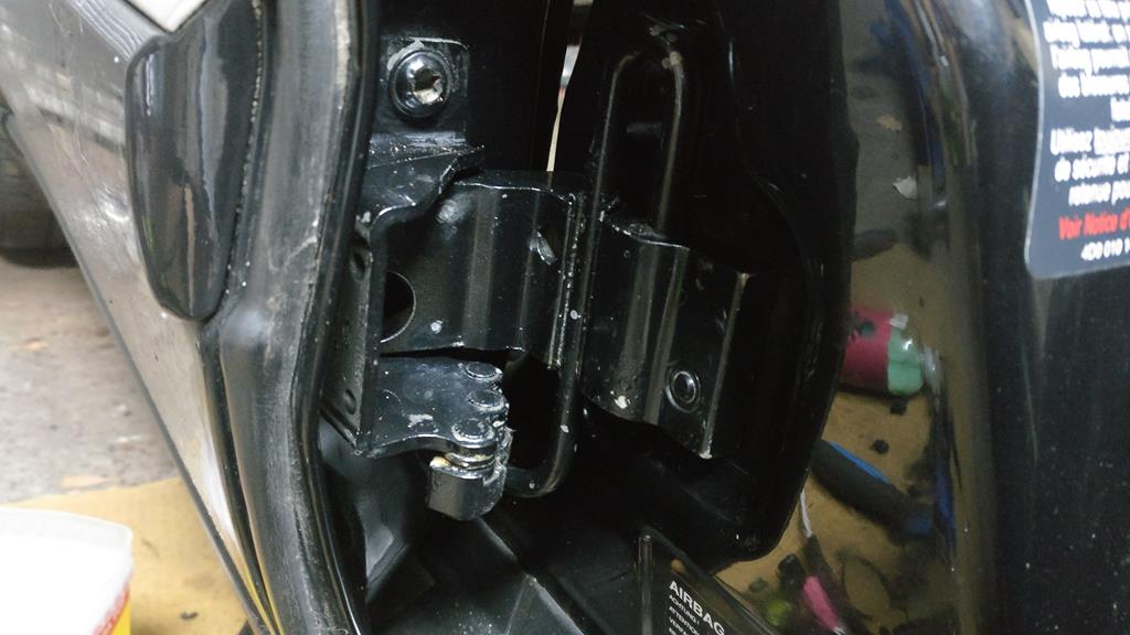

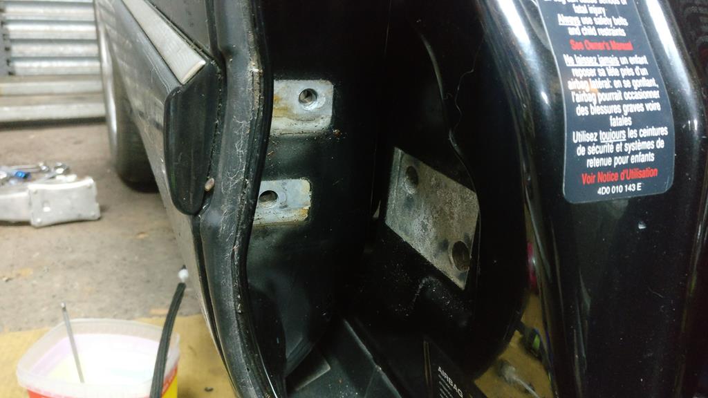

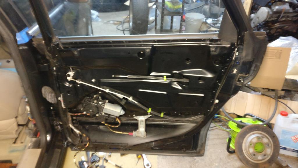

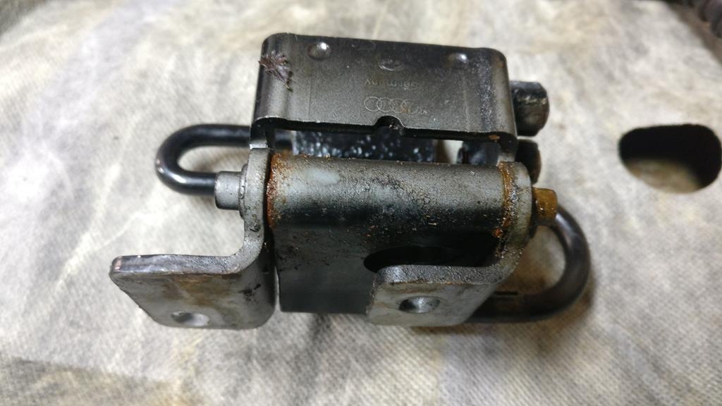

Turns out it was the lower hinge partially seized on the driver's rear door
Removed the hinge with the door closed so that it stayed put
Replacement hinge from Prestige in place and now the door opens and closes nicely

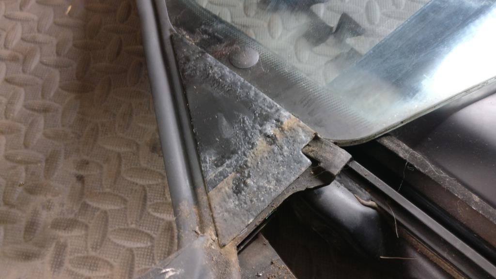

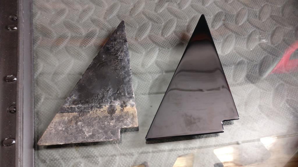

The rear door triangles are utterly ruined. I can't just leave this while the door is apart
Luckily I have a pair which have been powdercoated, flatted, and polished
I always mark the bolts when taking a window frame out so that I can at least start by putting it back in the same place it came out. Almost always this doesn't work and the frame still has to be moved about to close properly. I was quite surprised when this door went back exactly as it came apart
Back together just waiting on the door card

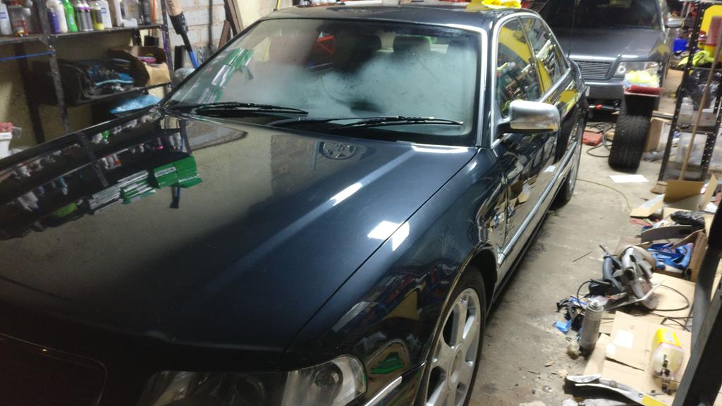

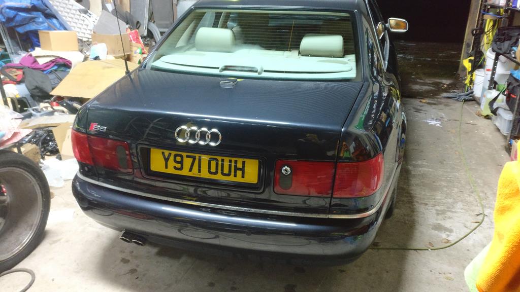

I hate to disappoint, but plans are already afoot for it to leave as a running project Its not economically viable for me to do a complete restoration on it, but its perfect for a capable DIYer looking for something at the bottom end of the market which they can work on over time.
I basically bought a leather dash which happened to be delivered in an S8. If the shipping crate is still usable afterwards, thats just gravy

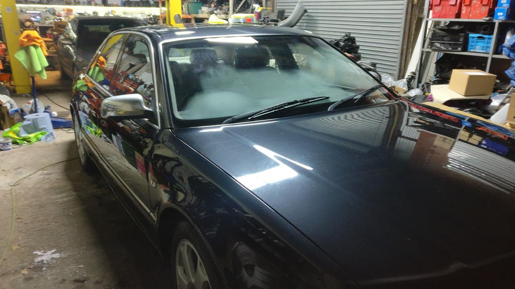

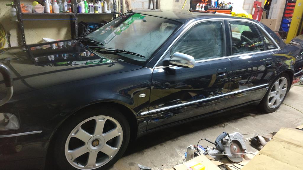

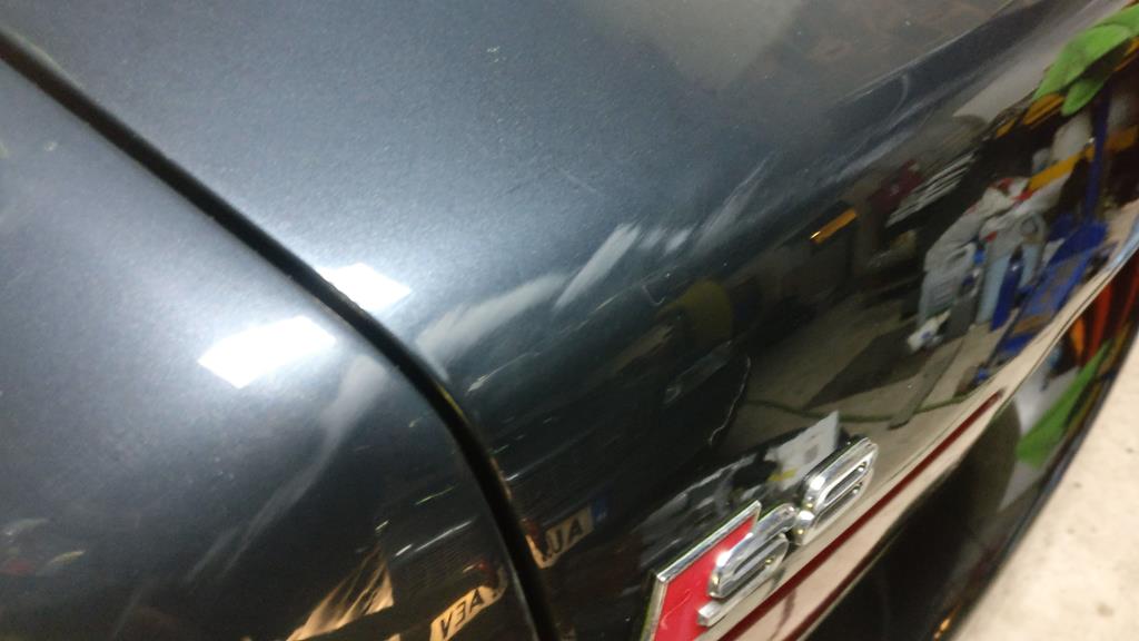

I put a temporary TCU in it this morning so it could move, and drove it outside for a bath. Cleaned up and under the workshop lights I'd swear its volcano black because its an anthracite grey, a stage or two darker than dolphin, but the paint code says ebony pearl It may be because the lacquer is quite dull and needs a good polish.

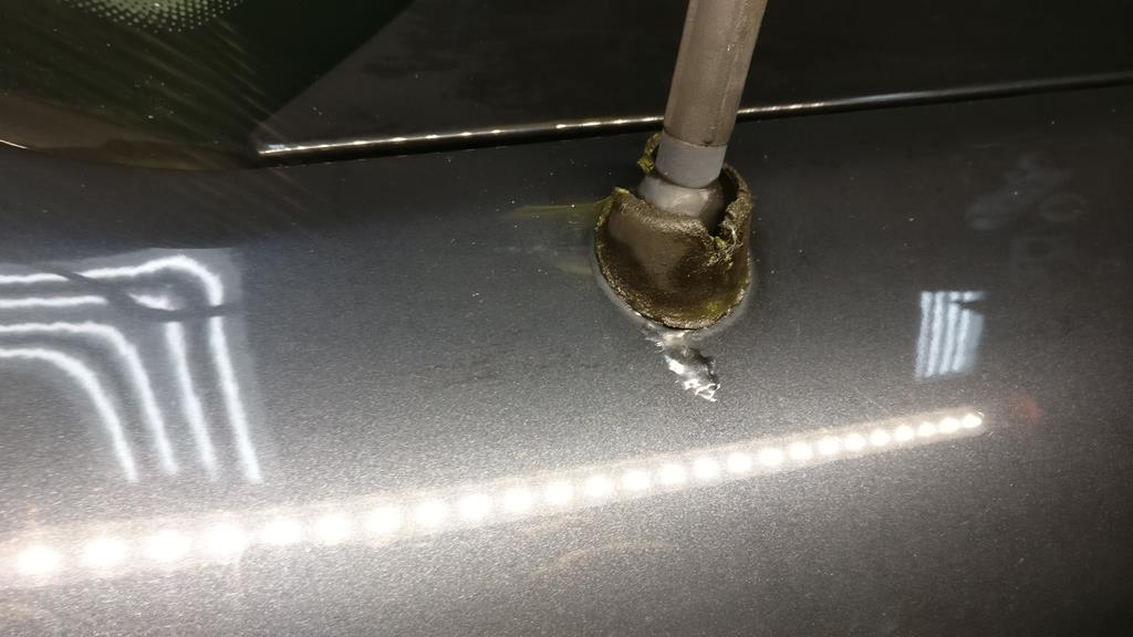

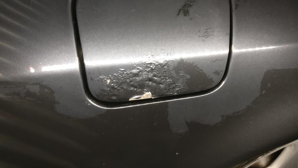

The bodywork is in pretty good condition considering its just been abandoned for six years. No etching like there was on Paul's FE, but some awkward corrosion in places. Some round the antenna grommet, a bit on one of the rear doors, and some on the A pillar from a careless windscreen fitter
The usual catastrophe on the fuel door
Its had a cover or tarp on it at some point, which has prevented etching but which has damaged the lacquer in a few places. Luckily this all disappears when wet so it'll likely polish out.
Some paintwork and a week with Nicola would have this looking superb, but the new owner is happy to take all that on so I shall be content with simply cleaning the salt off.
