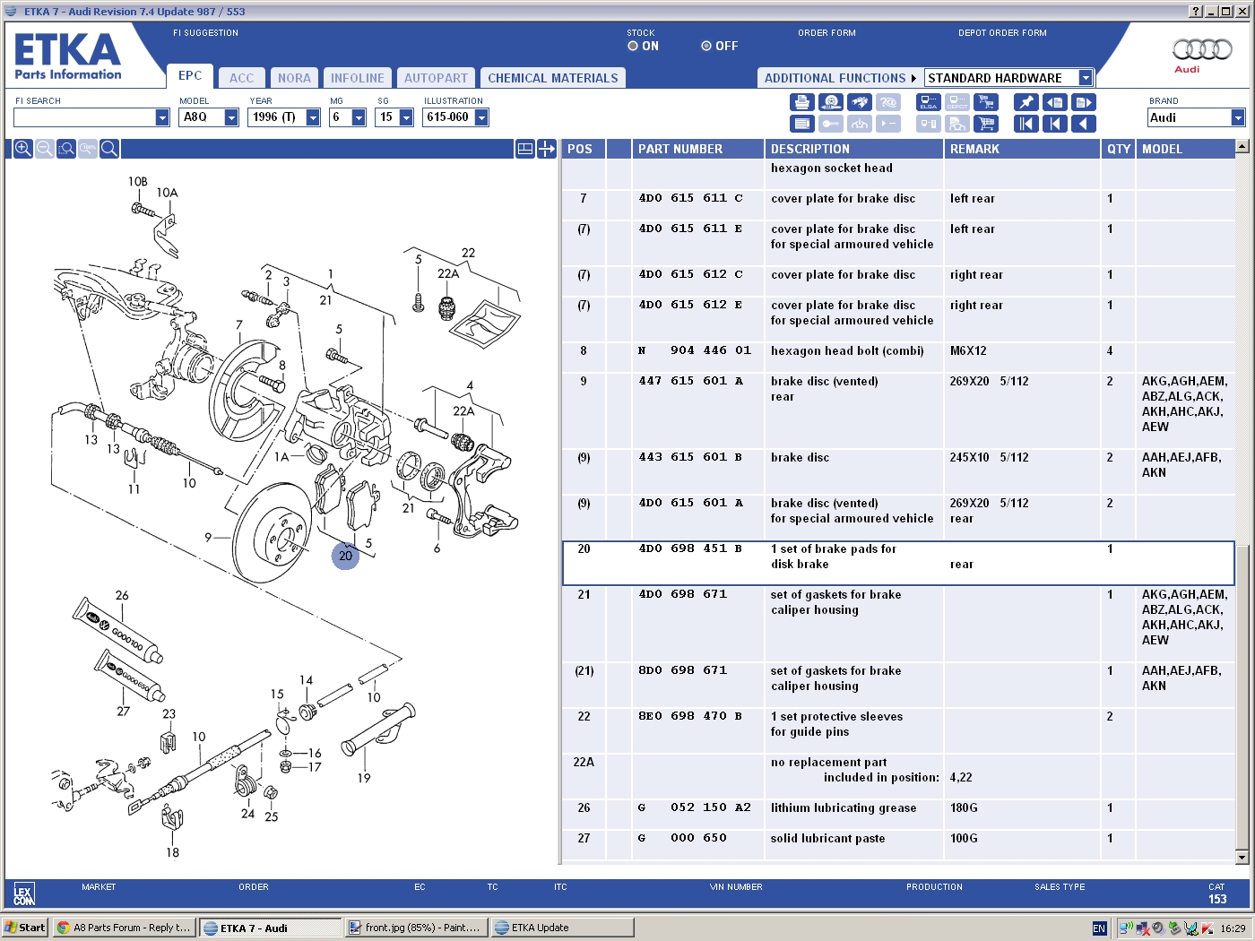

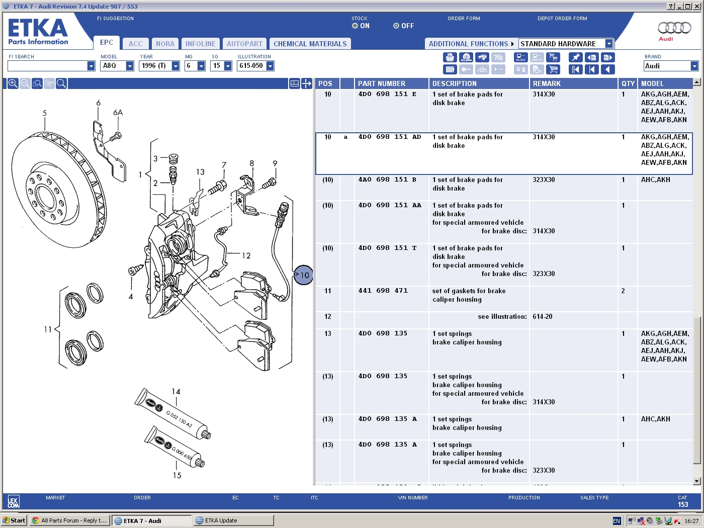

Old 16th October 2013, 03:31 PM
Posts: 3,854
Best to search by Audi part number or cross-reference. Hope this helps:

Old 16th October 2013, 04:26 PM
gti69 gti69 is offline
Join Date: Sep 2013
Location: Glasgow UK / Poland
Posts: 45
Thank you.
I actually went on the online version of etka: http://www.partscats.com/
Part numbers I have found (similar to yours above):
FRONT: 4D0698151E
REAR: 4D0698451G
Now started to look for cross references - Bosch ones.

Old 16th October 2013, 05:40 PM
Posts: 3,854
4D0698151E was discontinued on 01/10/2007, superseded by 4D0698151AD
4D0698451B discontinued 01/08/2007, superseded by 4D0698451G

The front ones are cheap but no mention of E or AD part numbers, does mention B which would be for 323mm. Like I said I think they are interchangeable but not 100% sure.

Thank you. Does your etka have vin check? If so could you please confirm for me if I provided you with the number?
Funny thing is that the cross reference for Bosch shows pads for 323mm discs and not 314.
