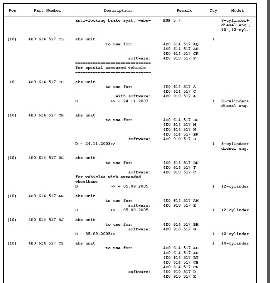

I pulled that quickly before leaving...
That's for V6 diesels and V8 petrols.
V8 diesels and 10 and 12 cylinder petrols have a bit more choice.

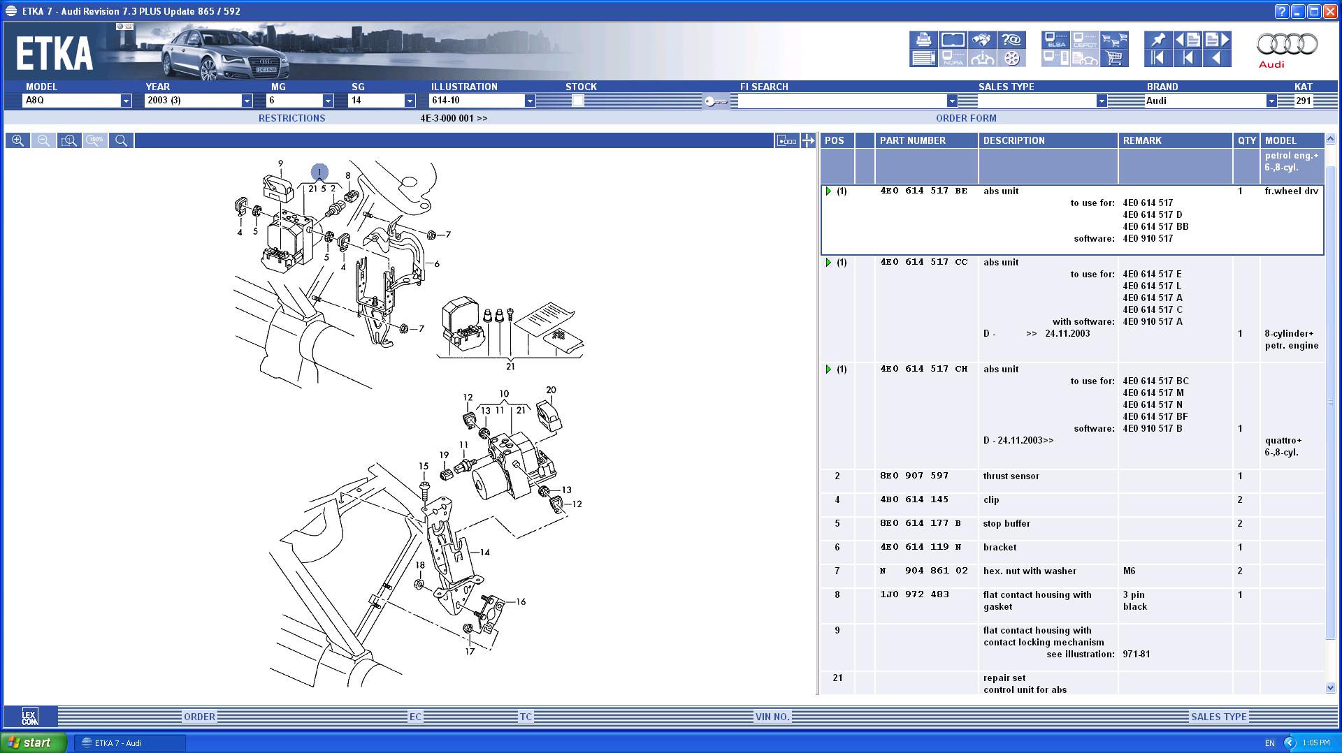

From your picture am I correct in saying that a BD should work fine is that 8 cylinder + diesel too ?
