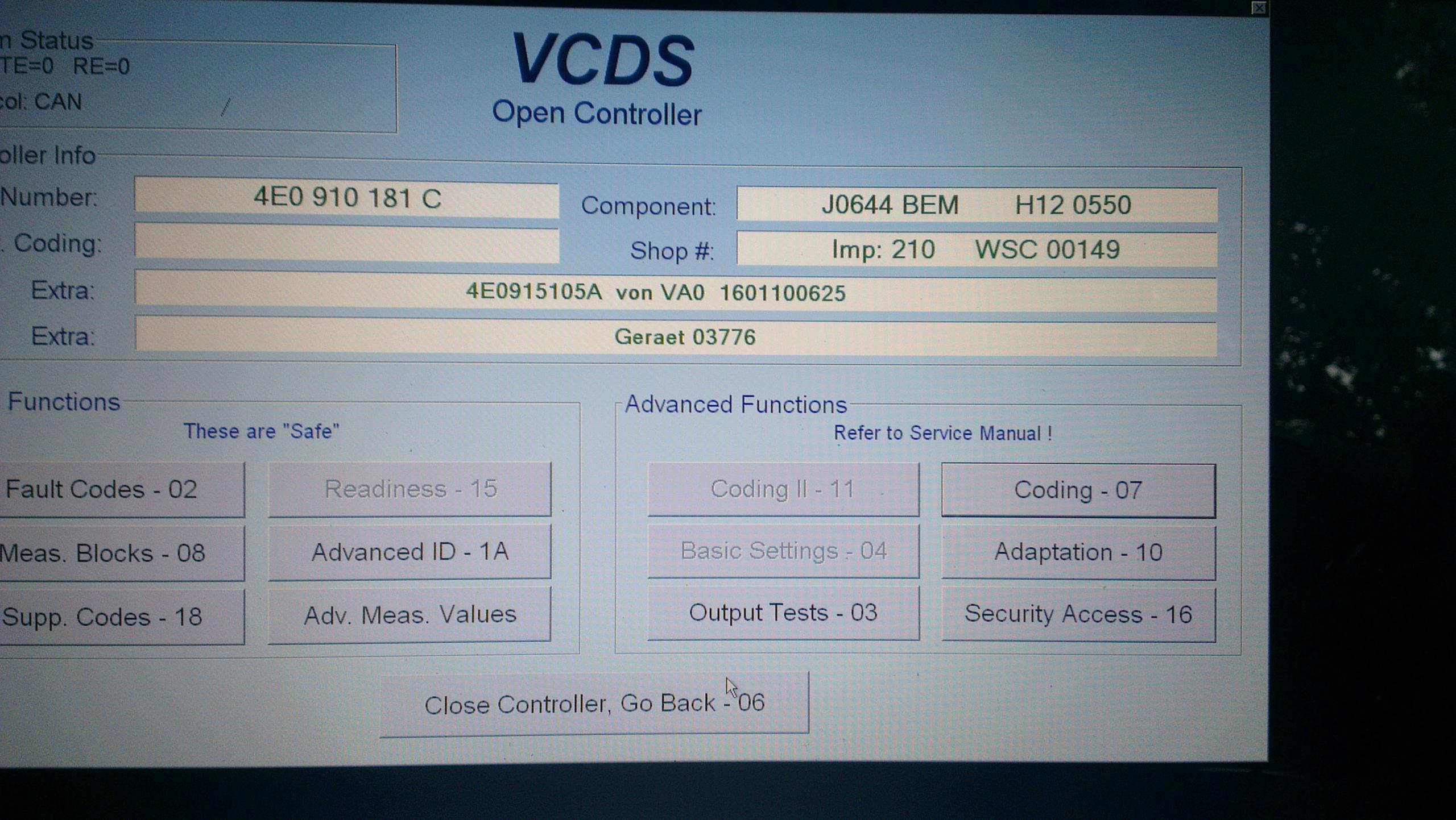

Phoned Audi and currently waiting for them to phone back with a quote and hopefully they will have some understanding of what I was talking about.
I also plugged VCDs in to check my software number.
I'm not sure which number is the software version.
0550 is the SW (same as mine) - according to the link above post by Architex, 0590 is the later version.

Only the dealers can update it with their VAS system, you can't update anything with VCDS or CDs in the MMI.
Dealers seem to hate it when customers go in asking for this kind of thing and either quote a rediculous price or make out they have never heard of such a thing.
