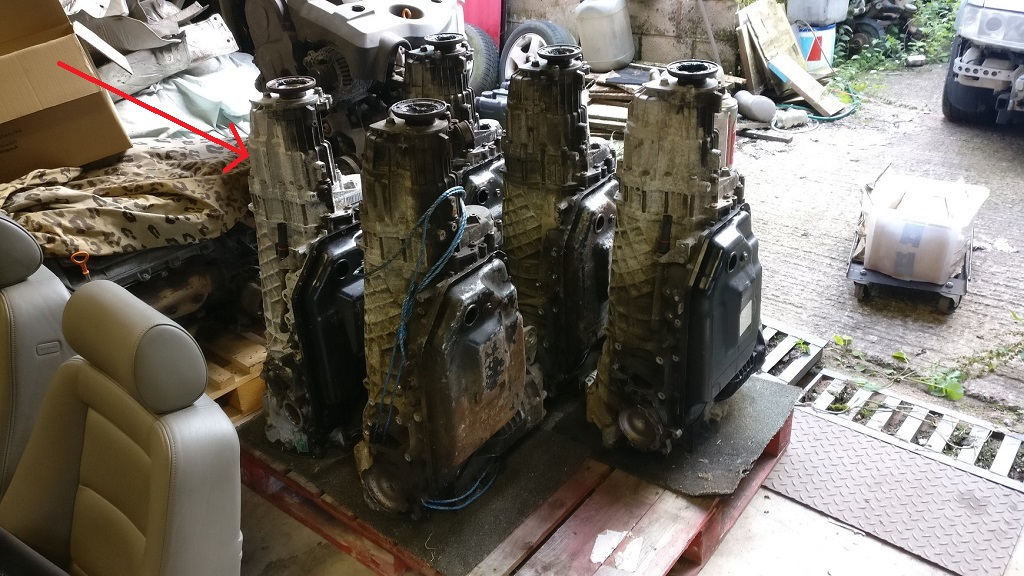

Loads of 'em yeah
Indeed, I remember helping to move them

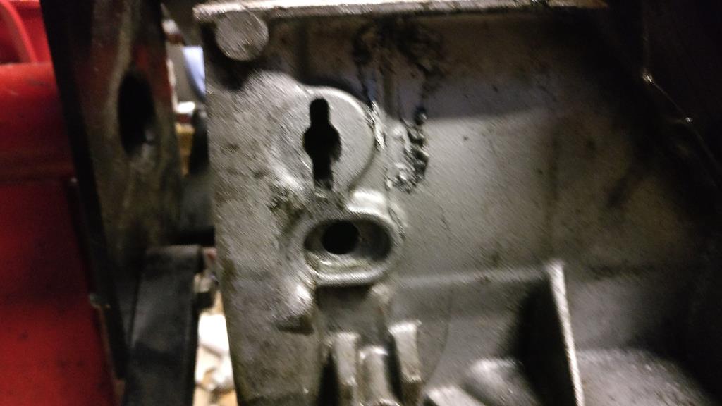

Given that they a; broke the casing, b; put gear oil in it, and c; siliconed all the seals instead of replacing them, I am considering this gearbox fubar. Thats a somewhat disappointing escalation from 'refurbished', but thats D2 life I guess.
I tore it apart to see what parts had been replaced and / or damaged to see if there is anything usable inside.

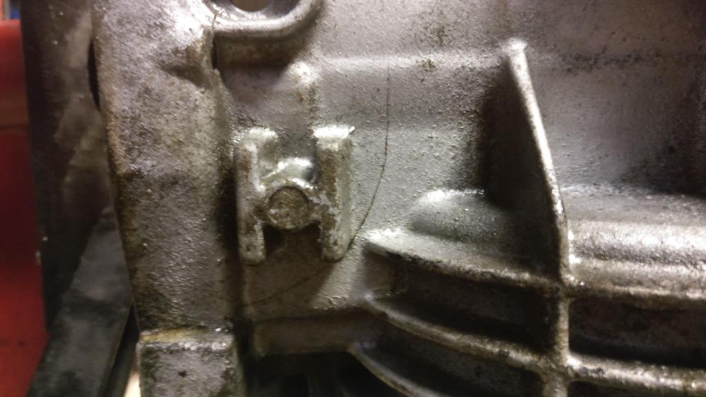

This is the crack from the outside - siliconed then painted over:
89Forever - yes you are spot on with how to deal with the contamination, but given the gearbox is now a parts donor, welding it becomes unnecessary.
This silicone was bugging me since I first got the car. Little did I know what crimes it was hiding

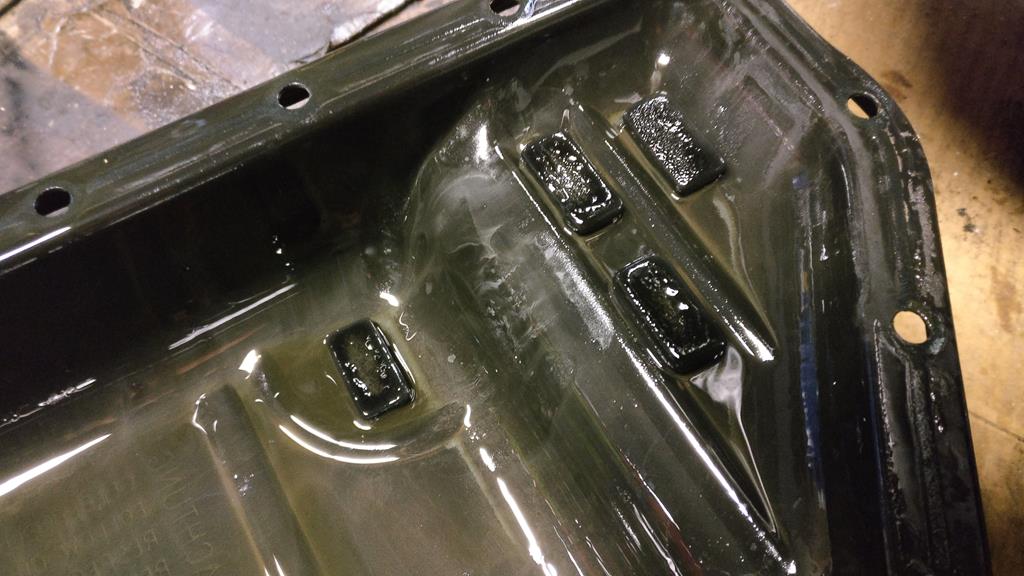

The sump magnets are missing. Not a happy sight in here, but no friction material so the clutch discs are probably still good. I don't know yet if they were replaced or not.

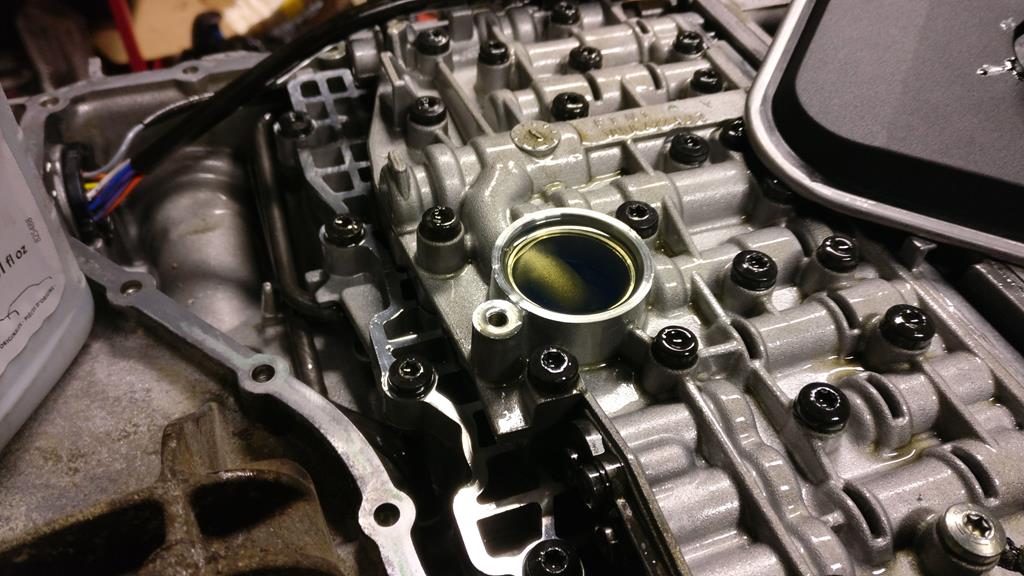

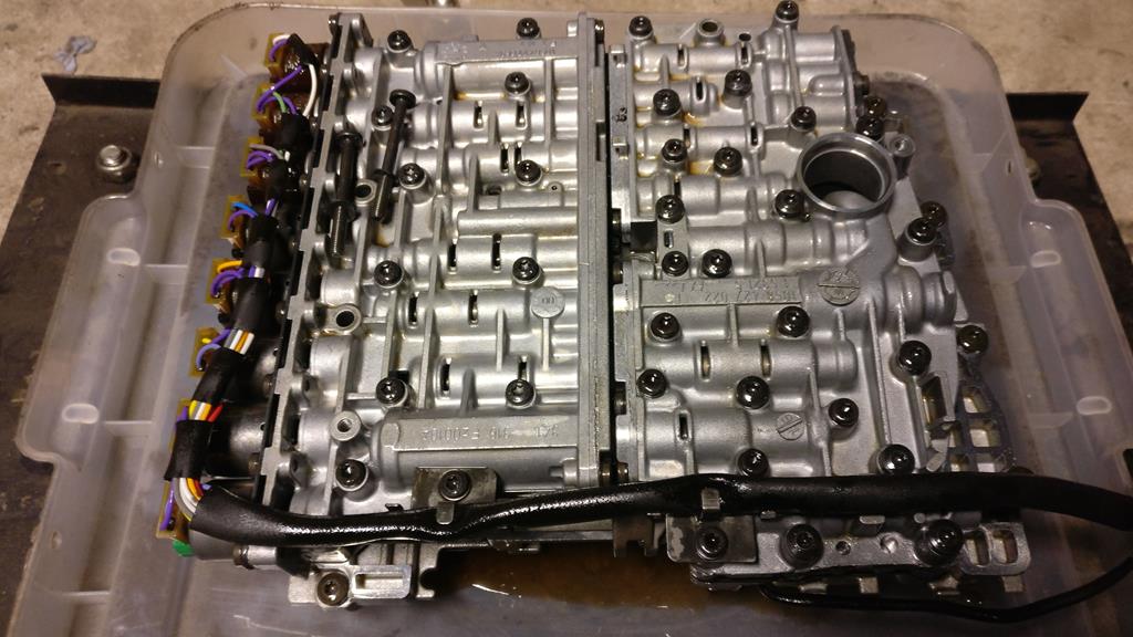

The valve body appears in good order and un-bodged, although obviously contaminated. I will keep this safe and possibly try fitting a Transgo valve to see what effect it has.

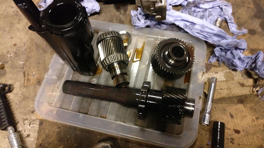

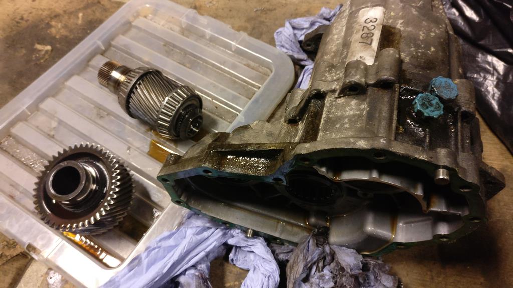

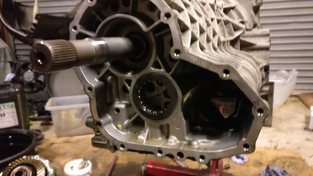

The drive from the planetary gears goes through the middle piece here which is hollow, and drives the Torsen diff. Drive then comes back from the torsen in to the gear on the middle piece then is sent to the front diff through the two on the right. The big chunk on the left is part of the parking pawl. You can just seen the toothed gear with which the pawl engages the front diff only. I never realised P only affected the front wheels. The rears can still turn through the Torsen.

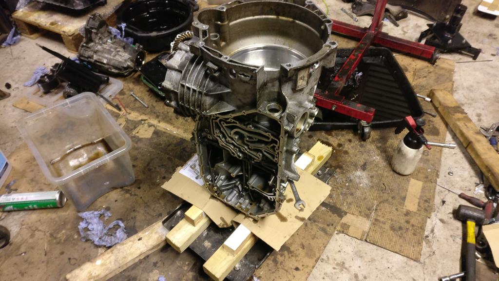

Back of the main casing

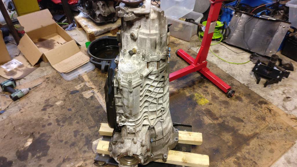

Impromptu gearbox stand so I could pull the clutch packs

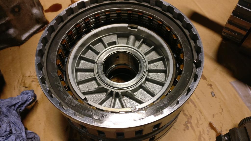

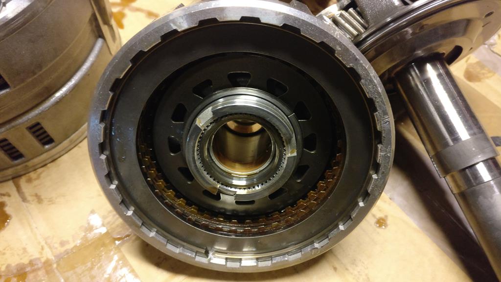

It's had the updated thrust bearing fitted

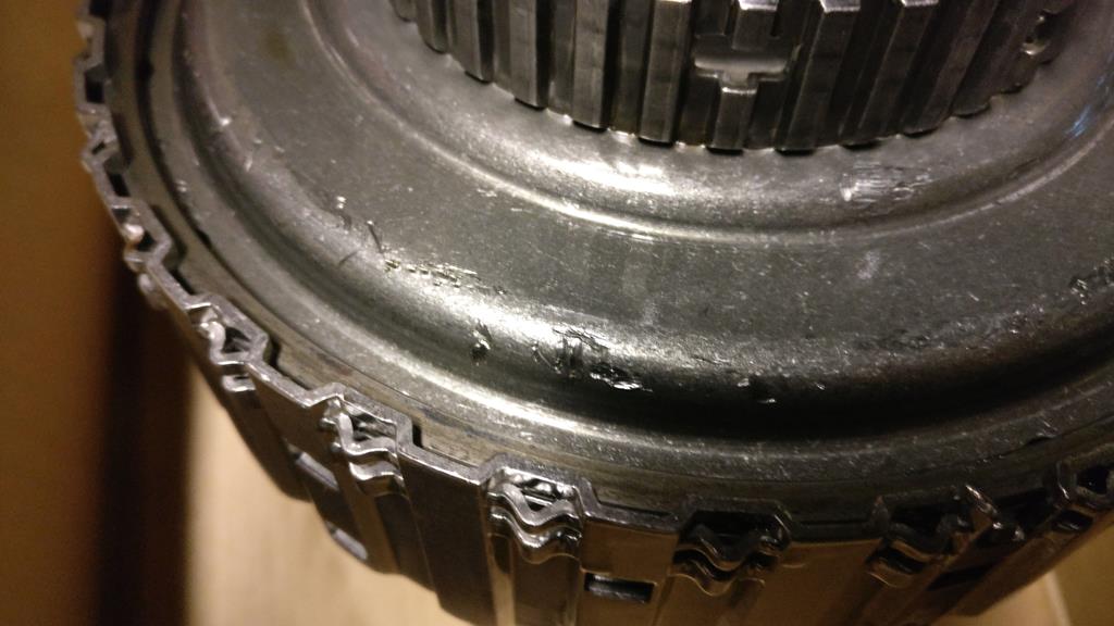

Apprentice marks on the clutch drum, which has also been replaced
More marks underneath on the second clutch pack.
I'm glad I pulled this apart since I can use the new clutch drum and bearing in something else, once the burrs and tool marks are cleaned up. I'll get the other clutch pack out tomorrow and see what state that's in.

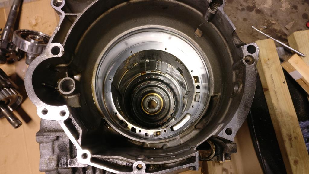

Stripped the rest of the gubbins from the broken casing yesterday. Now it looks like a big wash basin pedestal
Clutch pack
Another clutch pack
Planetary gears
Its still slightly magic to me that these are the only gears in this thing. It gets 5 forward and 1 reverse gears just by engaging these planetary gear sets in different arrangements using the various clutch packs.
Ok. Lets try this again with one from the pallet

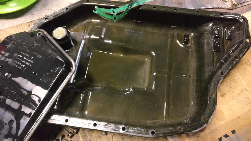

This is from my Avus FE. Having thought about which gearboxes I had available, I recall that this one worked but had a squeaky converter when it was in Bert's now-manual S8. So, I'm going to give it a service, and a different 'believed good' converter and see what happens.

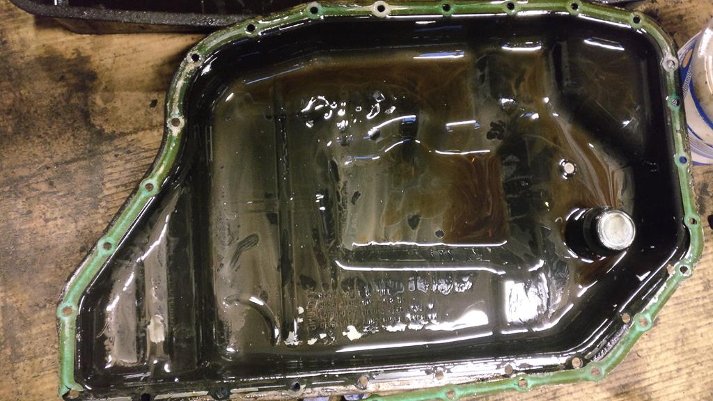

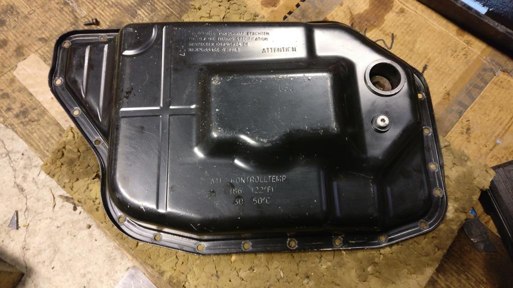

Relatively clean in the pan. No shiny chunks.
Magnets in place (bonus!) and not too furry.
Nice and clean inside too
This converter came from the S6 from which I had the mayonnaised engine. The gearbox had been 'refurbished' in that too, and it was working until the oil cooler split so I believe the converter is ok. We'll see though.

Cleaned up the sump and the magnets

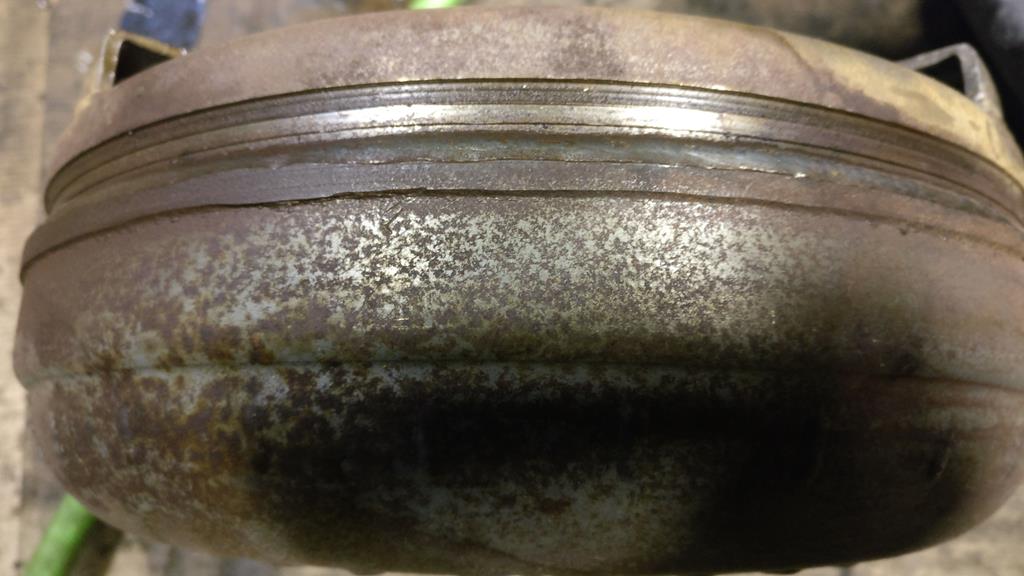

The converter I'm using has definitely been opened - you can see the weld bead where they closed it back up. A bit rough - JPAT who I usually go to cut and weld along the original weld seam, but it'll do if it works.

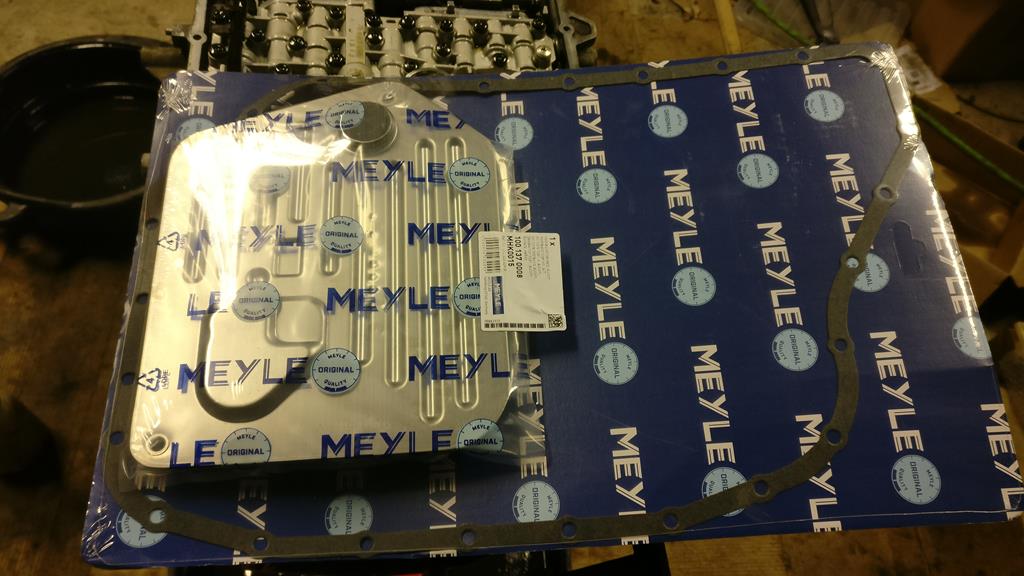

New filter and gasket

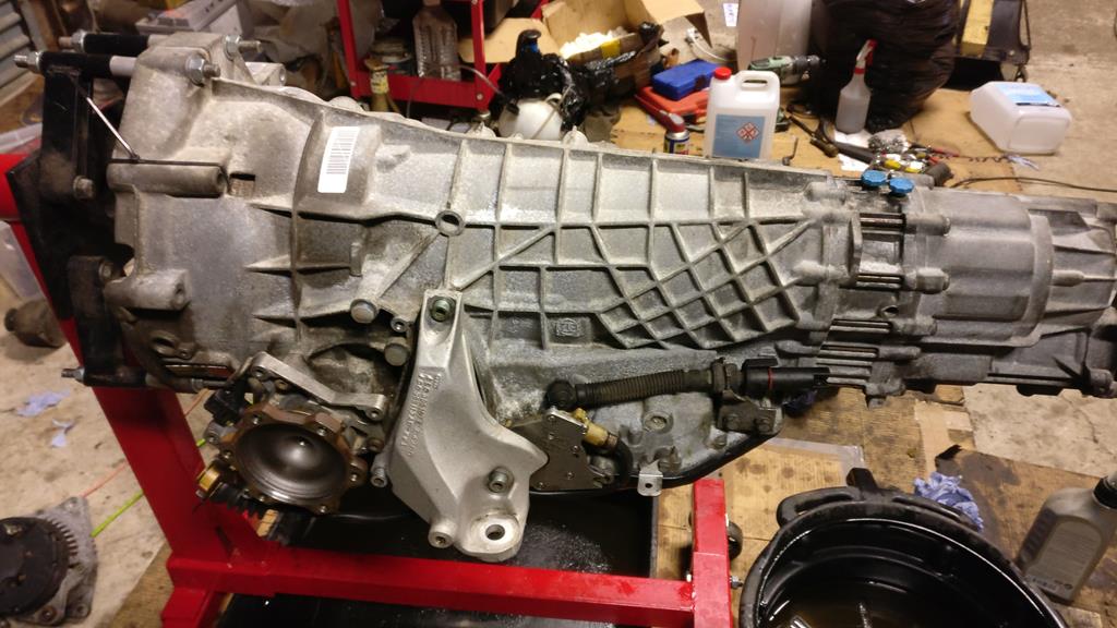

All back together
And back on the separating table
I still need to put the flywheel back on the engine, but thats simple enough. Hopefully tomorrow I will have these two joined together again and fluids in them.
