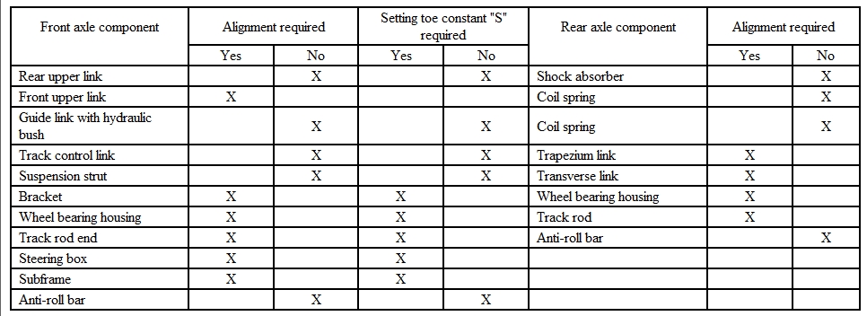

Here is the official list when adjustment needs to be done but I would suggest to have alignment done every time something is replaced on suspension.

Thanks for that - that suggests I don't need to do another alignment but take your point.
