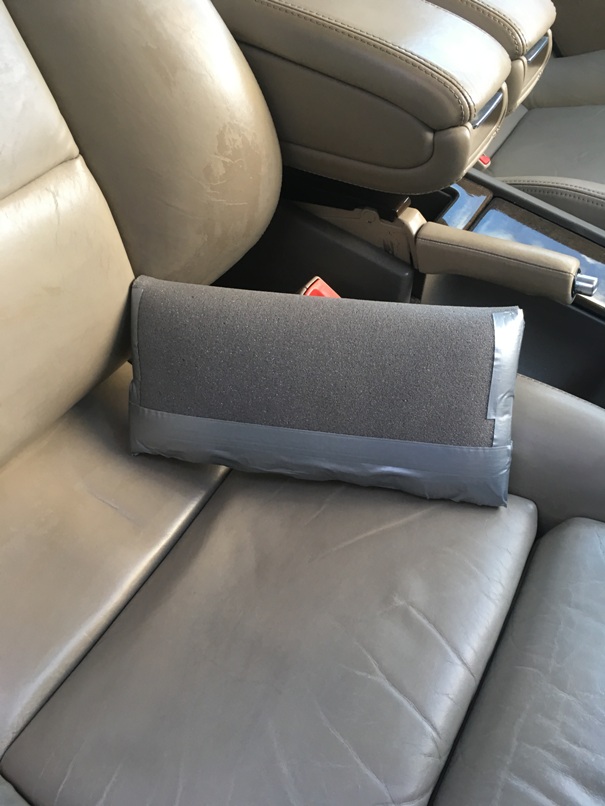

One fall-back plan I now have is much simpler though. Having "rummaged around" a bit there is actually enough access to slide something into the seat between the centre backrest panel and the lumbar support bladders.
And as luck would have it I had a 12" square of 1" thick seat pad foam, left over from replacing some dining chair cushions.
Folded in half and secured with duct tape it's the right size and a good test, though not quite as firm as the fully inflated bladders.
Worked it in behind the centre backrest pad and it feels much better now.
Edit: So much better that I've ordered a pair of the firmest (Severe, very firm) upholstery-grade foam pads, 12" by 6" and 2" thick with rounded edges, £9 delivered.

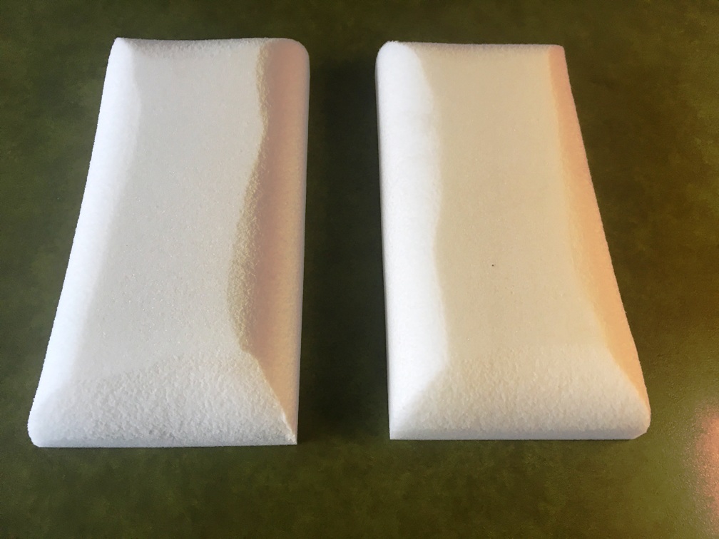

Arrived today, feel suitably firm, will slide them in when it stops raining - tomorrow maybe?
Edit: Put them in, needs a fair bit of force and wiggling as they are quite firm and the foam sticks to the seat and bladder materials; ideally need a fabric sleeve.
Not quite in the right place yet (maybe need to move down a cm or so, but still feel good ) but with the rain increasing I gave up.

Had these in for a while now and they work well for me in the drivers seat.
However SWMBO doesn't like the passenger seat one, says it's too high up, so I'll see if I can adjust it.
