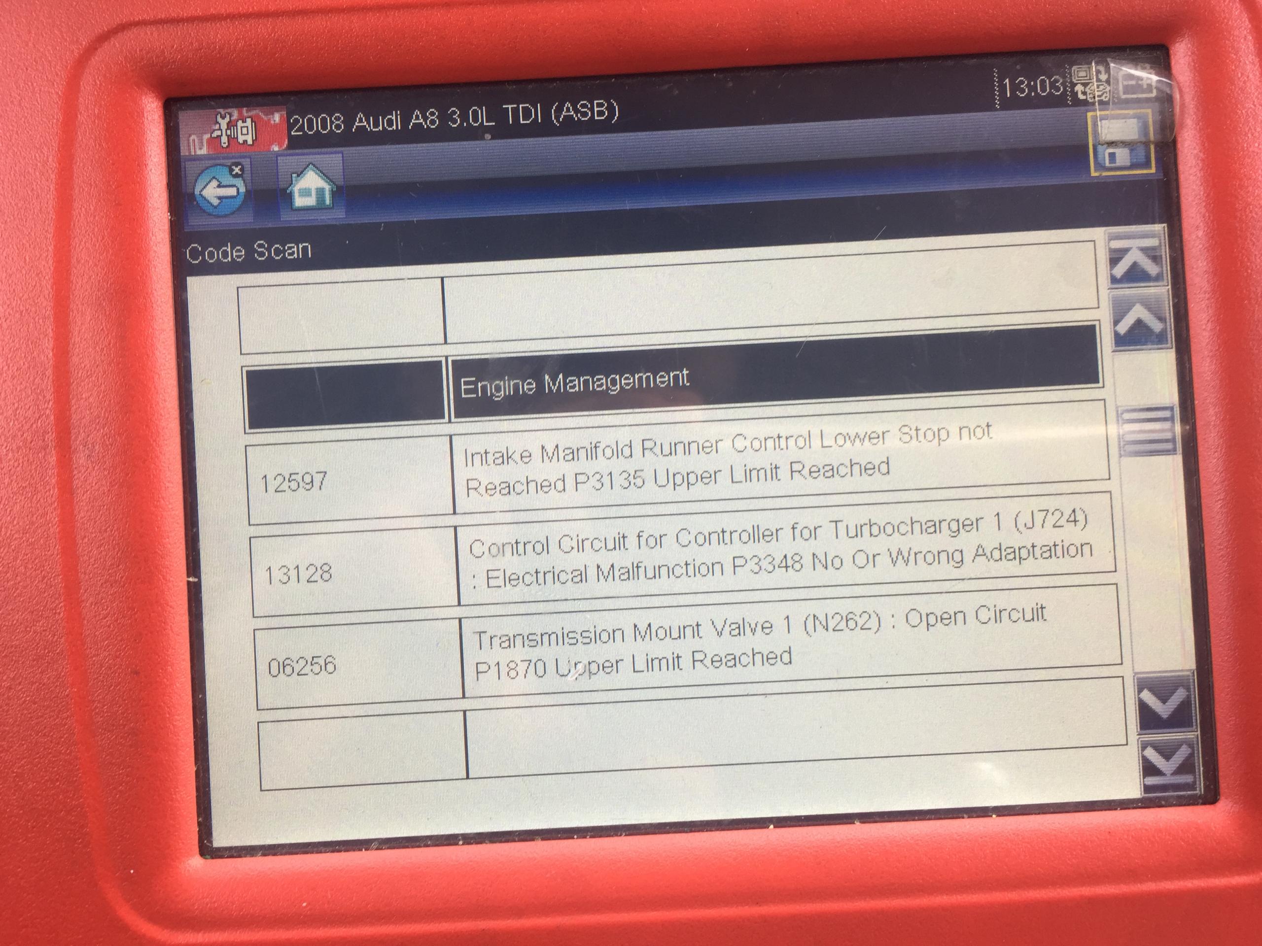

Scan tool image attached

Turbo sounds likely. Best thing to do is clear the codes and see if they come back as the machine on the photo doesn't seem to show when they started to ocurr and how often. Maybe it was a fluke 6 months ago and therefore a red herring.
