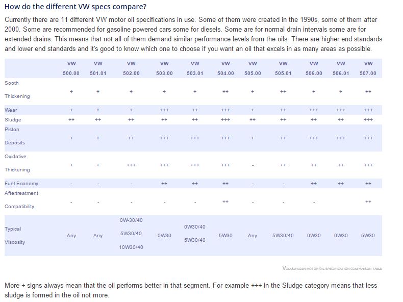

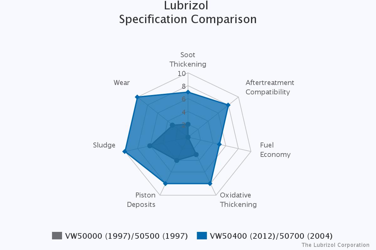

You cannot go wrong with Quantum Longlife III 5W30 which is VW 504.00 & VW 507.00 specification.
And 500.00 and 504.00 comparison

I'm glad you think so because I just took delivery of 20l of it
