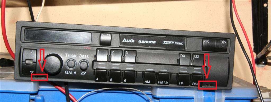

Great! Thank you. Have it out now, and cable in, however can't seem to switch it from the radio to the iPhone. I push the mode button and nothing happens. Hold it and I just get tp-mem and then the radio comes back.
What am I missing?

Looks like you need CD changer connected as well to allow it to switch to CD mode and use that input. So you need spitter cable something like this to connect both: http://www.discountcarstereo.com/AA8-HAR.html

Which exact model radio is that, I don't recognise it?

Ah right that makes sense. I suppose I could also splice into the existing line in to make it connect too?

I don't see why not. You can also make splitter canble yourself if you want, you can get plugs and pins here: http://www.nexxia.co.uk/products.asp...O%20Connectors, probably on the e-bay as well.
