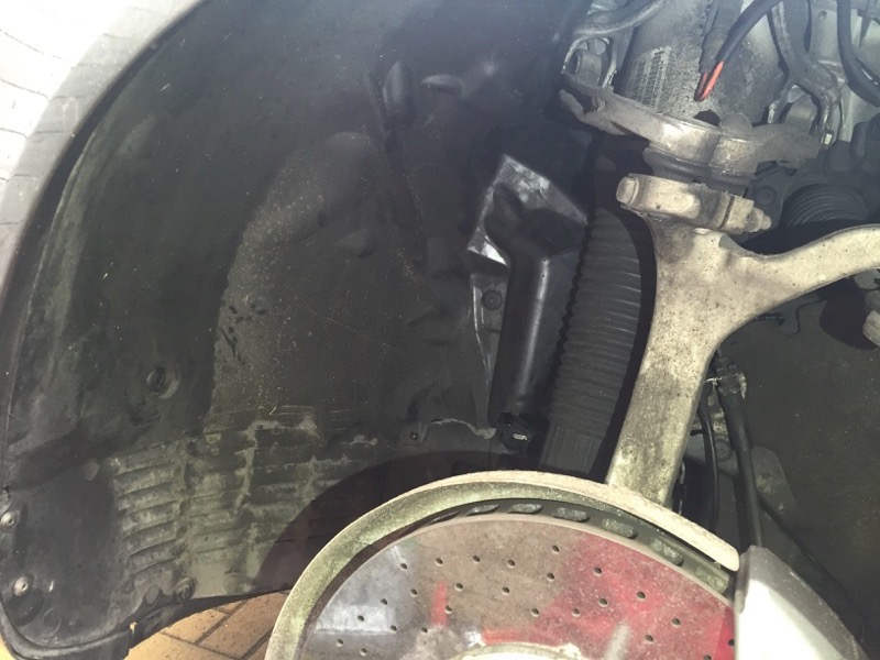

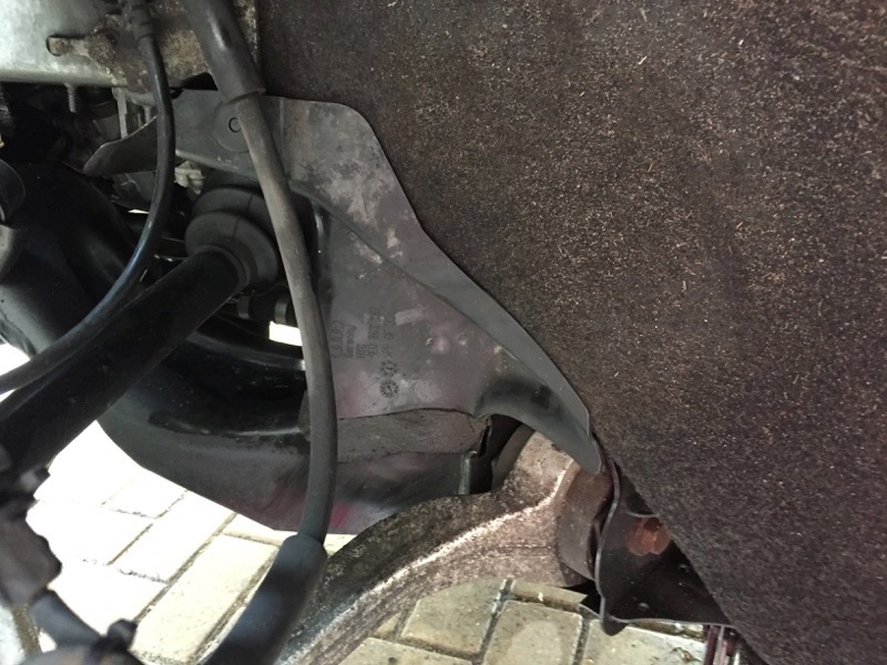

I have heard numerous people having the hose cut and joined and the OCD wasn't going to allow that if at all possible so started the investigation this morning and after pulling the liners from the wheel arch and the sump guard I found the culprit to be the return hose from the rack to the cooler.
On the S8 life is made easier if you remove the air box, wheel arch liners, cover that goes around the steering gaiter and also the fog light grill.

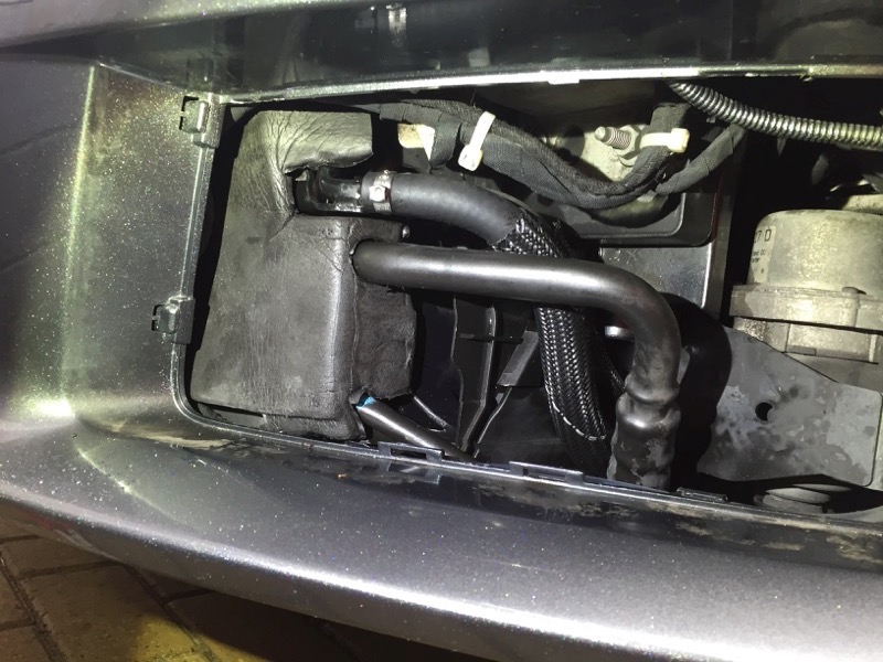

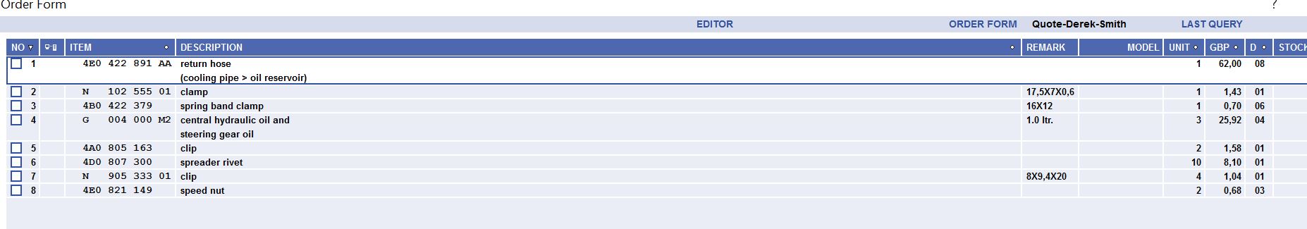

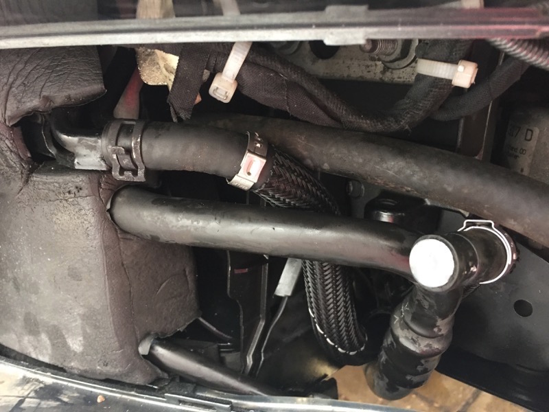

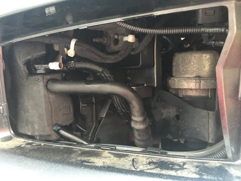

The hose thats at the front is the hose that returns oil from the rack to the cooler, cutting off the stainless clamp is the only way forward so I bought 3 of them, two to replce and one extra for any mistakes

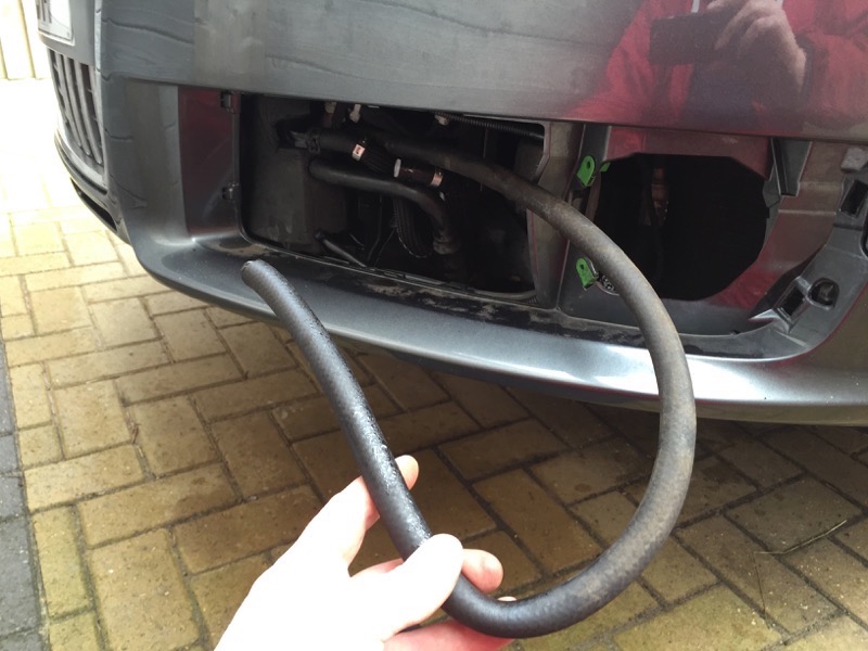

With the hose disconnected at the front from the stub and pulled back the damage was easily seen when the braided cover was slid back.

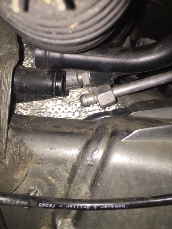

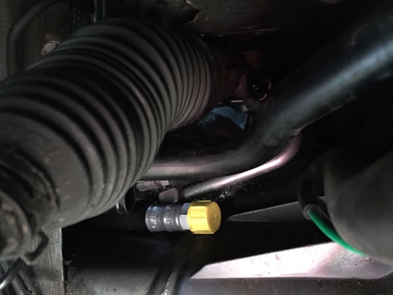

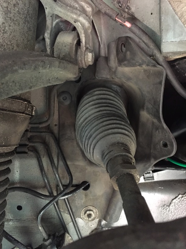

Other end of the hose is under the rack and access is tight but by no means impossible once the covers and wheel arch liner is removed.

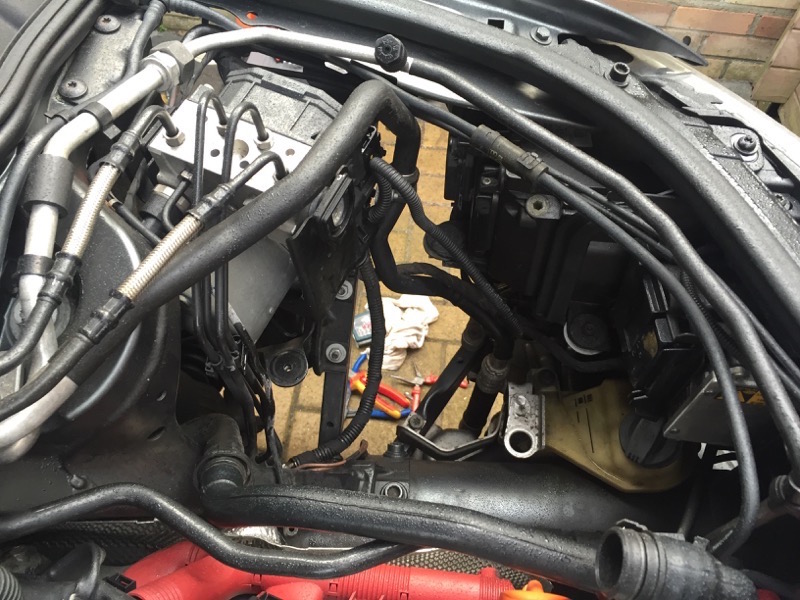

With the sound pipe (large black tube) pulled off and moved aside and the smaller tubing moved too the hose can be detached like below
The hose removed and awaiting for replacement coming tomorrow hopefully.
New hose fed through with cap still on to prevent ingress of dirt, once through remove the cap and fit onto pipe, I found that controlling the hose from the other side while lining it up with the pipe worked best, fiddly but not bad.

Items 1,2 & 4 were all that were needed the others depends on what you lose or break
