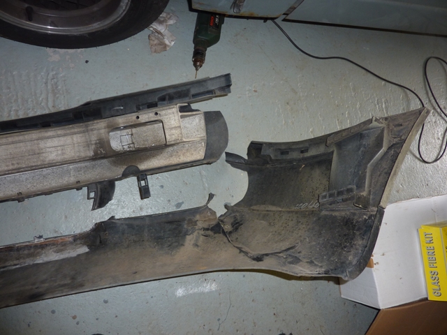

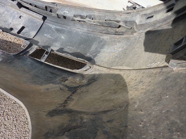

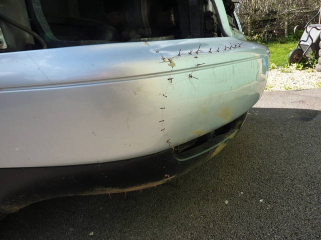

It wasn't looking hopeful, but in fact it was all there and not significantly distorted. Which made it possible to stitch it back together very effectively.
I've now 'glassed the back side and will add another layer before removing the stitches and grinding out the cracks and using a filler adhesive to fill and bond. Will also put some expanding foam in the re-enforcing structure along the top where I can't get in to 'glass it as there are some relatively minor cracks I'd like to support. Even before the 'glassing it felt quite strong.

The existing paint job is sufficiently grisly that a competent rattle can patch will probably not show much. Concours it ain't, but it's that or end of the road.
