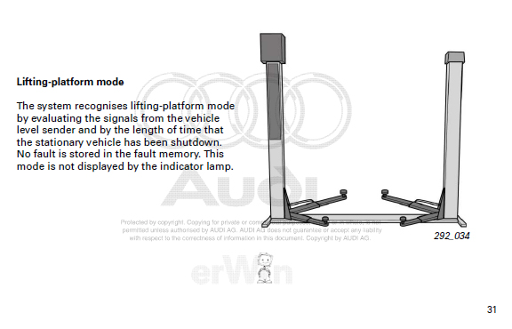

Jacking mode need not be activated when lifted on a garage lift as the suspension module can recognise when it's being lifted, as taken from Audi SSP.
Fundamentally Jacking mode is a human safety feature to stop the car adjusting and potentially unstabling itself while raised on a jack.

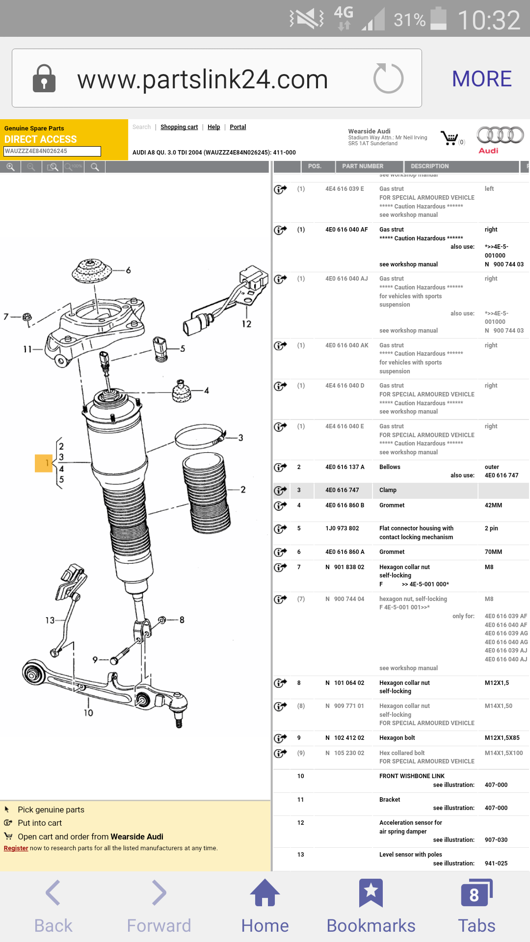

Hi sorry phones been broken and I've been working away without laptop. Cars still in the garage kwik fit been out too see it at regional managers request, apparently he was a audi master tech but didn't know jack about the a8 the bill now stands at £1215 with hire car fees included. The cause seems to of been off the acetylene torch while trying to loosen the bolts. Still arguing over who's fault it was. It's part 12 in the photo I've lost the other photo's I had of the damage.
