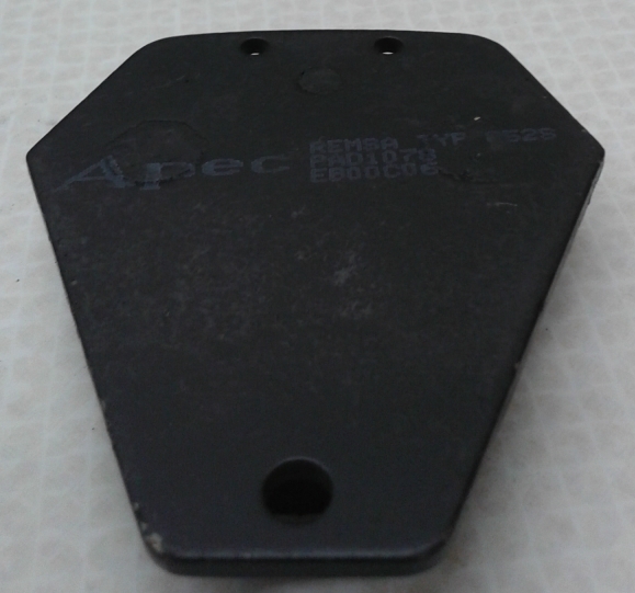

TRW is part of ZF now which among other parts make gearboxes and steering racks in our Audis, Remsa is part of TRW which makes friction materials. You can get retail TRW branded pads and many of OEM pads are made by TRW, I have seen Audi OEM pads made by TRW and TRW stamped on them more than once. I don't think Remsa is selling retail pads under their own name, at least I have not seen any but they make pads for a lot of other brake companies. They will make whatever specifications customer requests so there will be good and not so good. By the way Apec pads from e-bay I linked earlier are also made by Remsa.
Here is the picture of Apec pad with REMSA on it as well. Also just noticed that it says for 314x30 on the box so they will fit for 314mm brakes and they do fit for 323mm as I am using one set on 323mm brakes.
