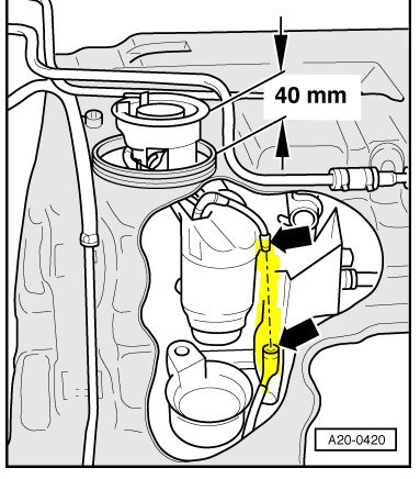

Have you looked at ElsaWin istructions? I have done it on 3 cars with success. The important bit is to get this pipe to slot in the right place.

Apologies if you know this already but the Service Manual for the Fuel Supply Sysyem (in the Tech Dump under "D2 - Common Faults" ) Sect 3.6 has a step by step guide to the fitting of the pump.
I printed it out for my indy garage when they checked mine for fuel issues. They put their smallest technician into the boot to do the job but he still complained that it was a barsteward of a job.
