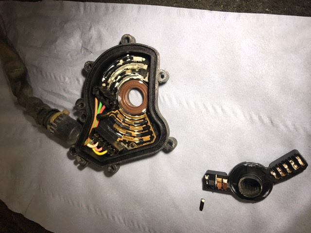

The news is less good on my D2 - the MOT is sorted ok and new washer motor, track rod end and some fettling with the brake wiring to stop an intermittent brake warning light is done, but unbelievably the F125 switch on my gearbox has had to be replaced due to one of the internal components corroding and breaking off, and as this was one of the contacts it meant that the F125 was inhibiting starting of the car and throwing up warnings or not sending correct messages to the auto box, so it has had to be changed
I'm really quite annoyed about this as the box has barely done 25,000 miles from being changed and I'm also told the rear output seal is starting to dribble which means another job to change that shortly too. Is that really acceptable on a box with that low mileage from new? I know it is probably 5 years since changing it but geez surely there has to be some better longevity in a new box from Audi than that? Yours. . . . disgruntled in swindon

I feel your pain after mine failed last year.
Its a cr@pp, flimsy piece of electromechanical equipment which really should have been re-designed/re-engineered a long time ago.
"Made in Spain" it says on the box for my replacement.

Wow that's really poor after such little mileage
Old 9th February 2017, 03:10 PM
On a brand new transmission? that is really bad.
And the leaking rear seal too, I remember on my D2 it kept re-leaking until I got the whole new re-designed flange and new seal, but I sold it not long after that so I don't know how well the new flange held up.

Presumably the new gearbox had the original design flange and seal, in which case the leak is about due. My first D2 had one at 2 years old.
